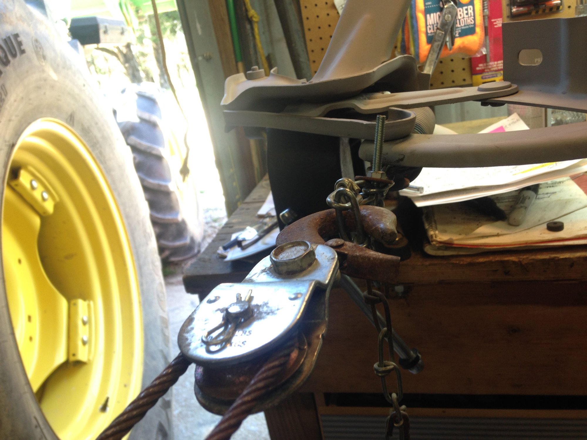

Thanks for all the good recommendations. I have successfully re-attached the spring and it was not that difficult. I made it harder than it should have been (see pic using tractor). I did two different ways. One was using the tractor, "come along" , and my vice which was overkill. The second was much easier. I re-attached the hinge to my replacement Cab (out beside the shop) backed my tractor up to it attached the come along and a small chain as was recommended and it was no problem.

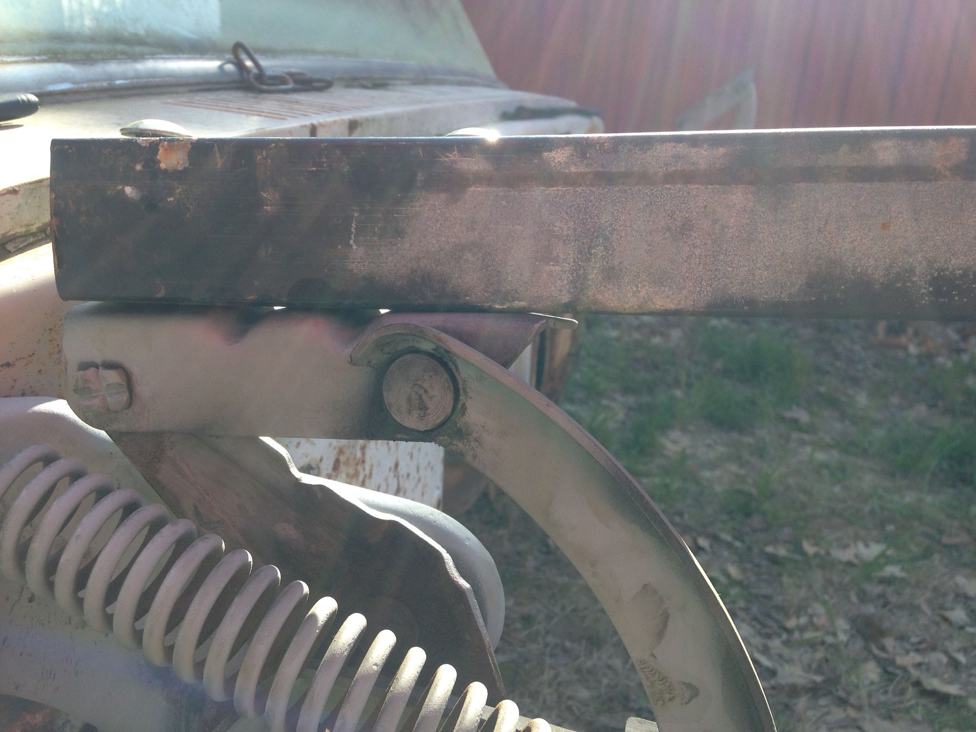

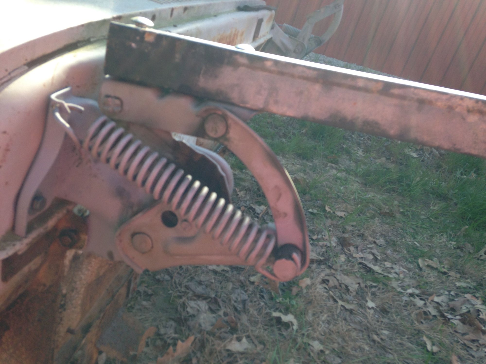

Same subject different question: I attached a piece of scrap metal to one of the hinges and bolted it down (see pic) where the hood would bolt on. The spring in the up position measured about 4" then I pulled down on the metal bar to simulate shutting the hoop just to make sure it would work. When I simulated shutting the hood the spring measured 8". I guess I did not realize the spring would be under that much tention when closed. I am I missing something or is the normal.

The force from that stretched out spring when the hood is down is what helps to lift the hood when you open it. Just like stretching out the garage door springs when the door is closed.
