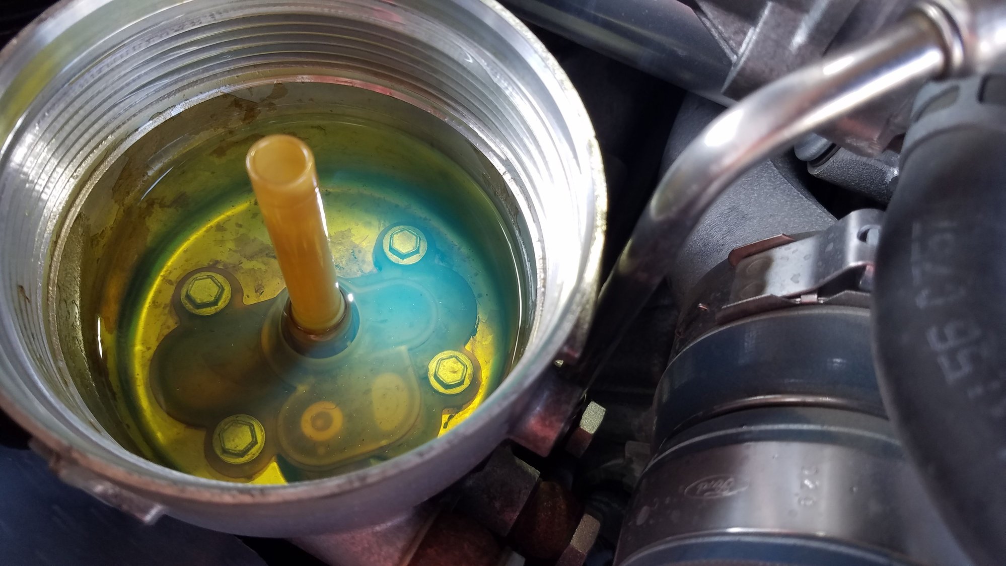

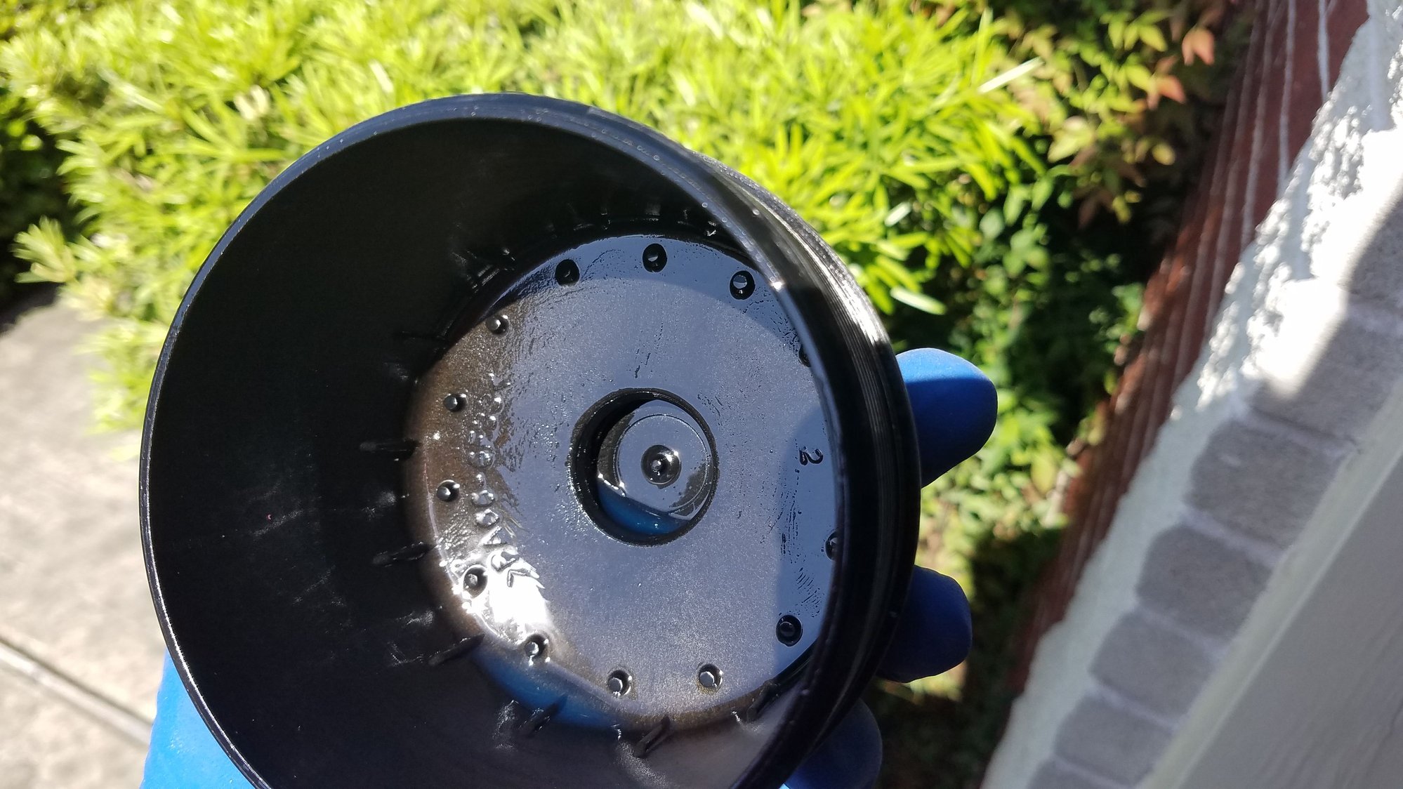

So I performed the works on the truck over the Easter weekend. I hope everyone had a good one. Oil/filter, fuel filters, intake filter, cleaned the engine. She purrs. However, in the fuel bowl at the secondary filter, I noticed an ever so slight presence of what appeared to be some shine flake. I've never seen this before. Am I totally FUBAR'd screwed? I take such good care of this...it pains me to think about.
Thoughts? Am I okay? I feel like I want to take another look in the fuel bowl to make sure. Truck runs like a top. Fuel filters looked good like they always do...though there is more sludge on that primary filter than I would like. I started trying to pull **** out of the primary (horizontal fuel bowl) by hand but could only get so much. I felt like blowing water in there and just letting it air dry...decided against...blowing water into the fuel/water separator.

I sure wouldn't come uncrimped over what I'm seeing. Are the particles suspended on the fuel or at the bottom of the bowl.
I would throw in the new filter after a total swab out (No water). Let dry and use a fine nose shopvac to back that up. Any time I do a filter change I drain, swab, take non chlorinated brake cleaner, reswab and vac. That's on the 7.3 and 6.4. I use lint free cloth, such as an old t shirt, (white), so I can take my scope and see what is going on. Eyeball the inside of your old filter, should look at least 50 pct brighter than the out. (at your intervals).
If I were seeing big shards then yeah, I would start "crapping your oatmeal". Remember Pic, this is a mechanical unit and you can expect to see things like I'm looking at. That's why due diligence on filter changes are necessary and the way you baby that thing, let's face it........when/if it goes, you would be throwing your money and sleep away to attack it until then.
Give it a month and reinspect it and see if it gets worse. Our filters are 5 mic's I believe which is infinitely small. I don't think you can catch anything with a blind eye that small, so your filter maintenance will def payoff.

these flakes typically appear during/after cold weather/
the cause is fuel starvation due to the difficulty fuel has getting thru the filters in cold weather...diesel gels in cold weather
prevention is anti gel and a fuel lube
so, now that you have it...what now
extreme cases of metal flakes could clog injectors open or closed
you basically have the begining of fuel pump wear
I had some flakes 2 tears ago from the previous owner not using anti gel and fuel lube
I changed my filters, fuel lines to the injectors, pulled my tank , etc
while I think my hpfp is worn, I can still pull 37lbs of boost so maybe my pump will get me by until the next time I pull the cab.

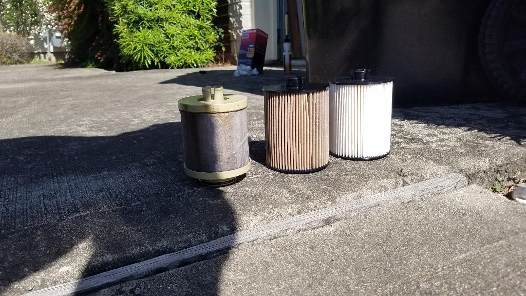

The secondary filter always looks good. The primary is the only filter that has ever had any kind of brownish particulate or gunk on it. You saw the pictures and I know I've posted filters 1 or 2 changes ago. No one said anything bad was happening then, and the filter doesn't look any different. Does the primary look bad? I may be able to get a better picture of it.
Pictures I forgot to include.
