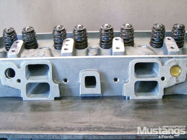

Does anyone know which port in the y block cylinder head feeds the number three cylinder?
thanks
jerry

Looks like the top runner of the rear stack.
