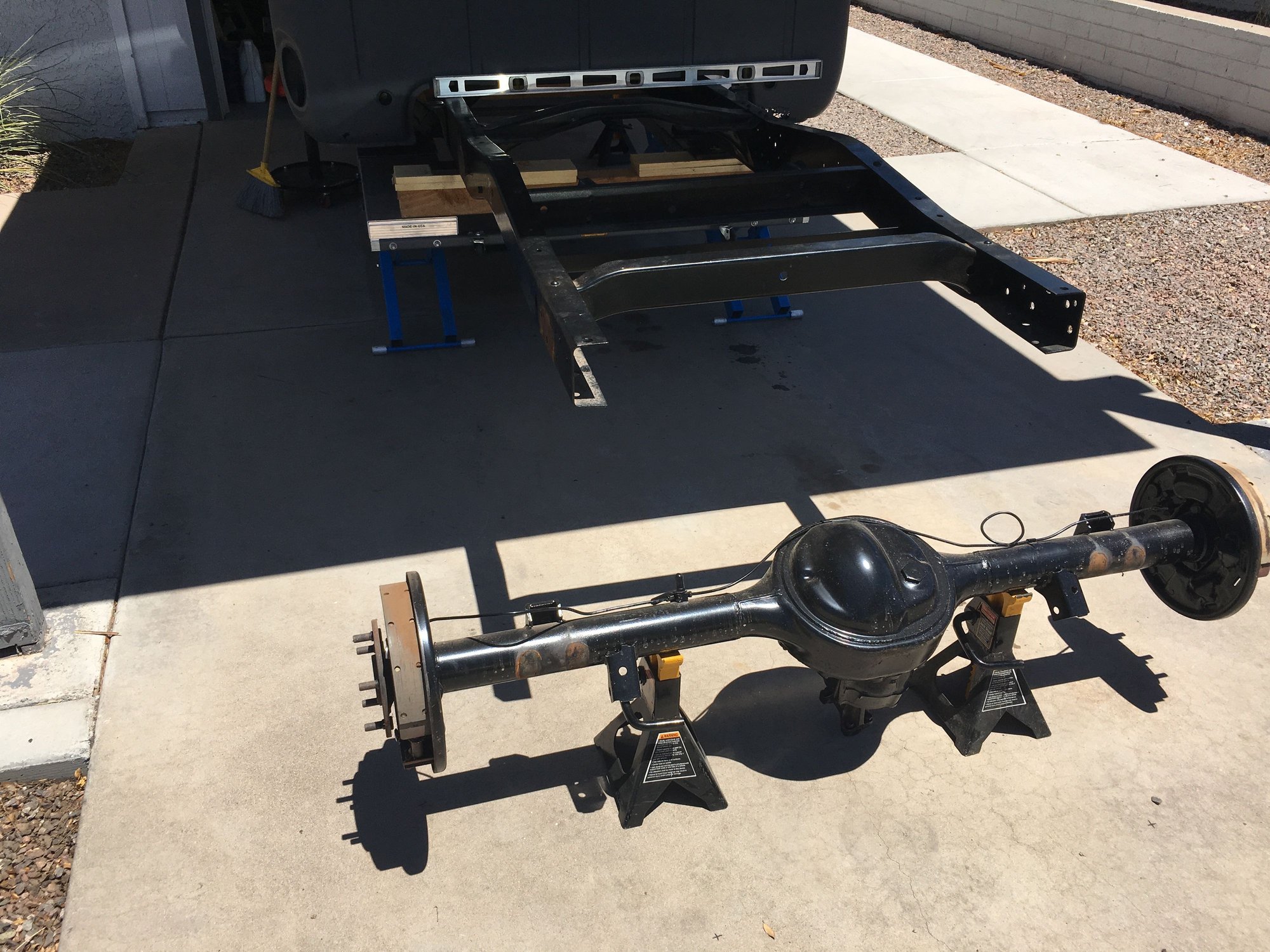

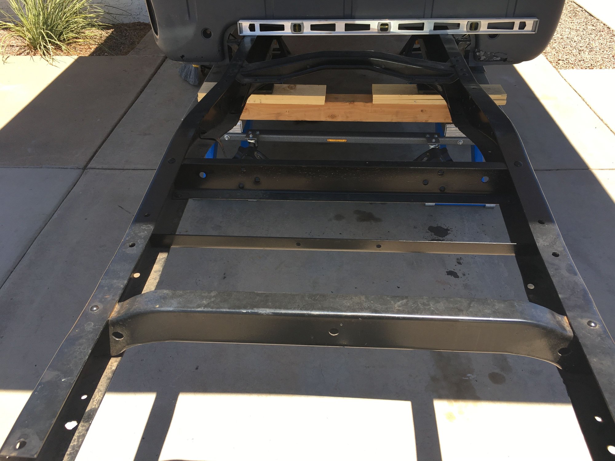

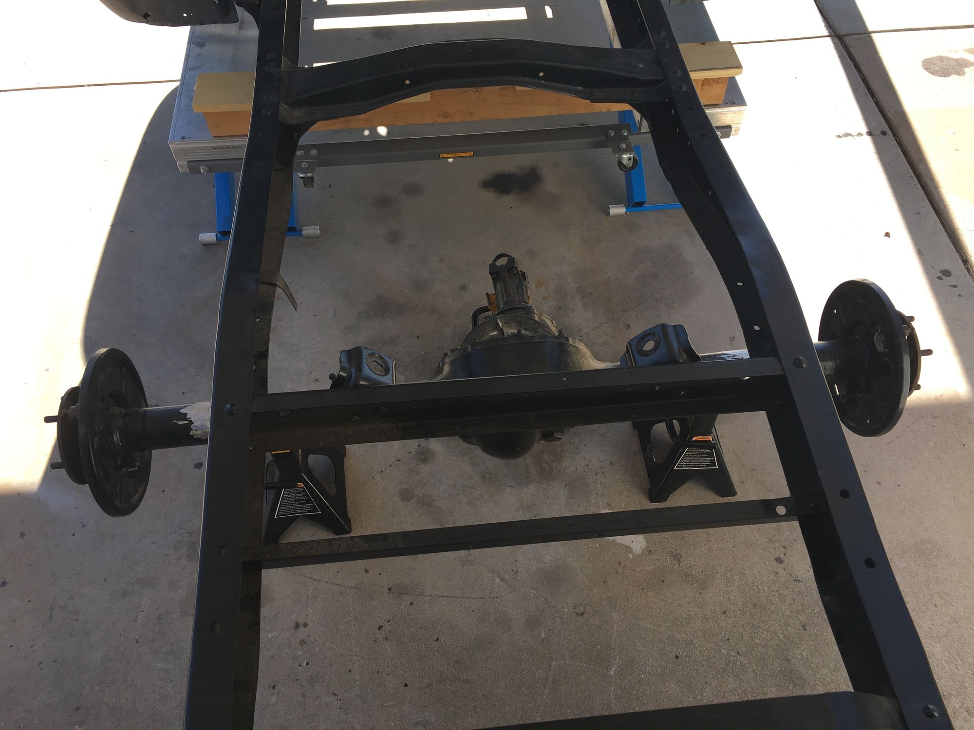

And, here's a couple of pictures from today.
I got the rear suspension off the truck and got the brackets off both the truck and the rear in preparation for installing the 4 Link rear suspension. Took a different method to the rivet removal today. Grinded the heads off, drilled a small hole in the center and then used a bigger drill bit to get just enough past the surface. Seemed to be quicker today, but still hate rivets.
Getting the rear ready to start setting up the rear suspension.
All the brackets cleaned off. I am not sure if I will need to take the braces off yet. Once I get the 4 Link rear in place I will see.
The rear removed, and the old suspension is off.

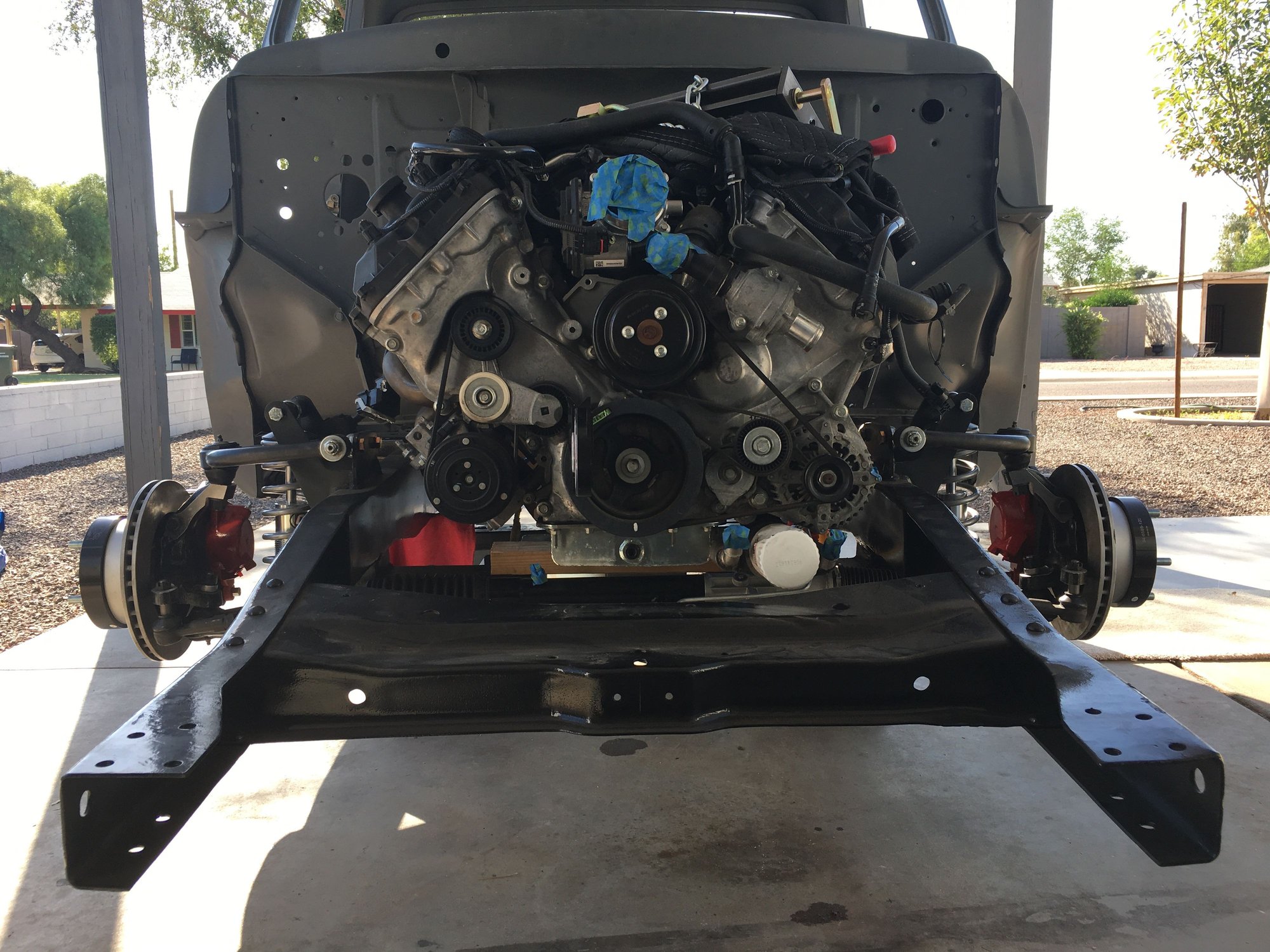

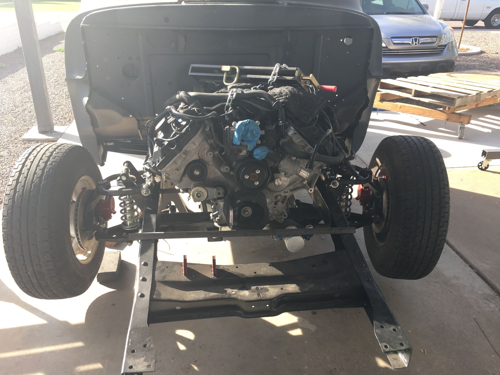

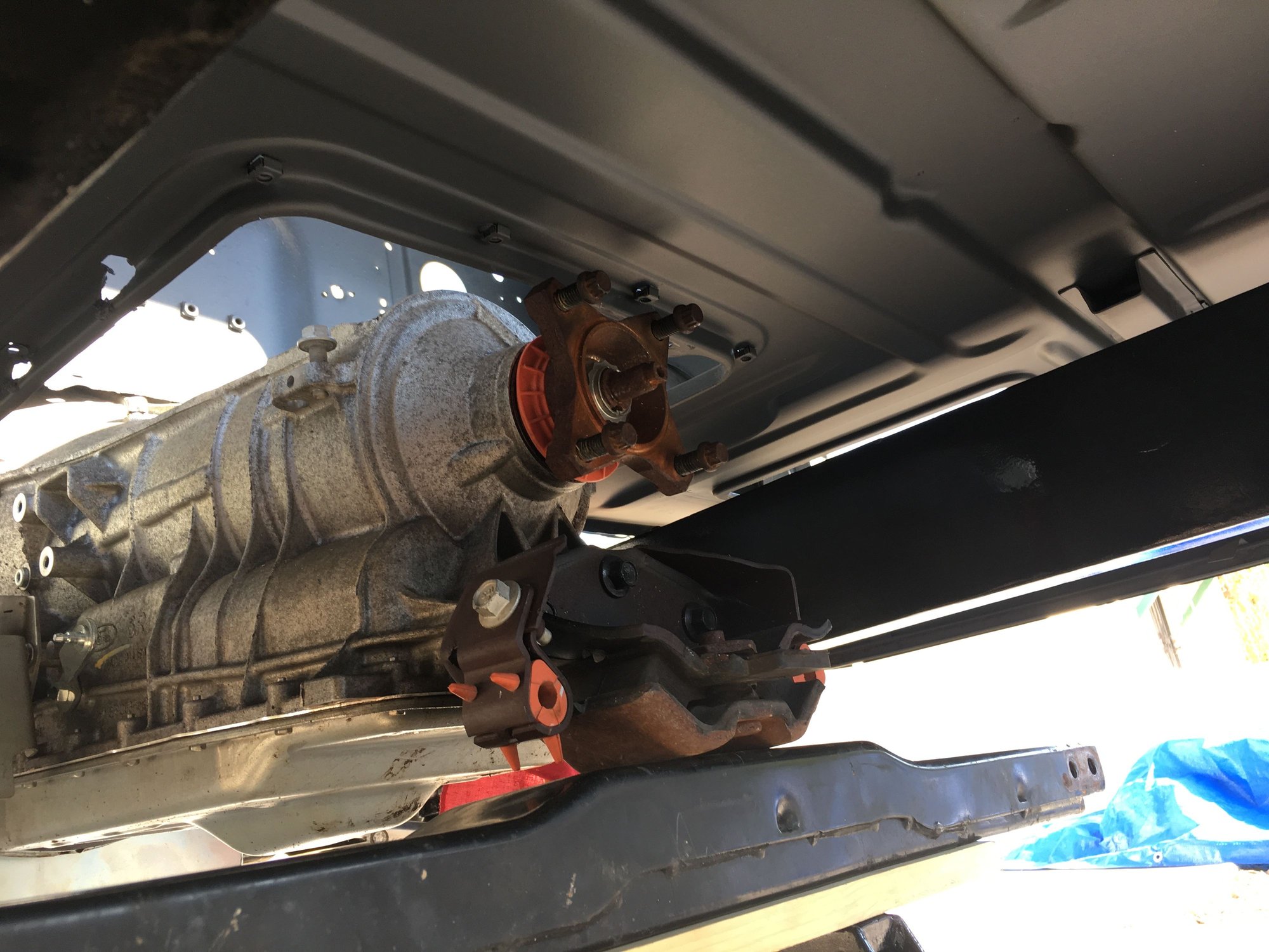

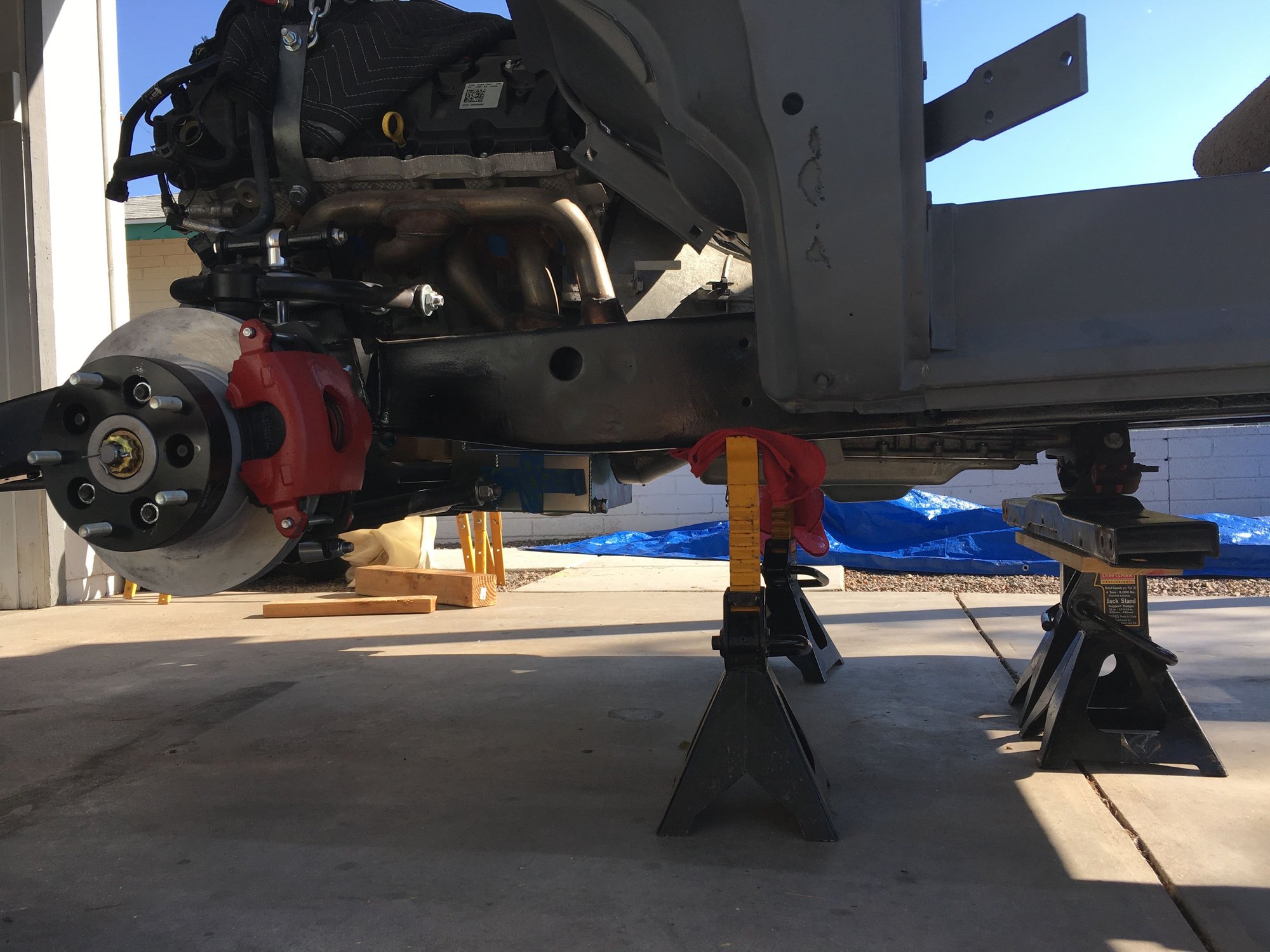

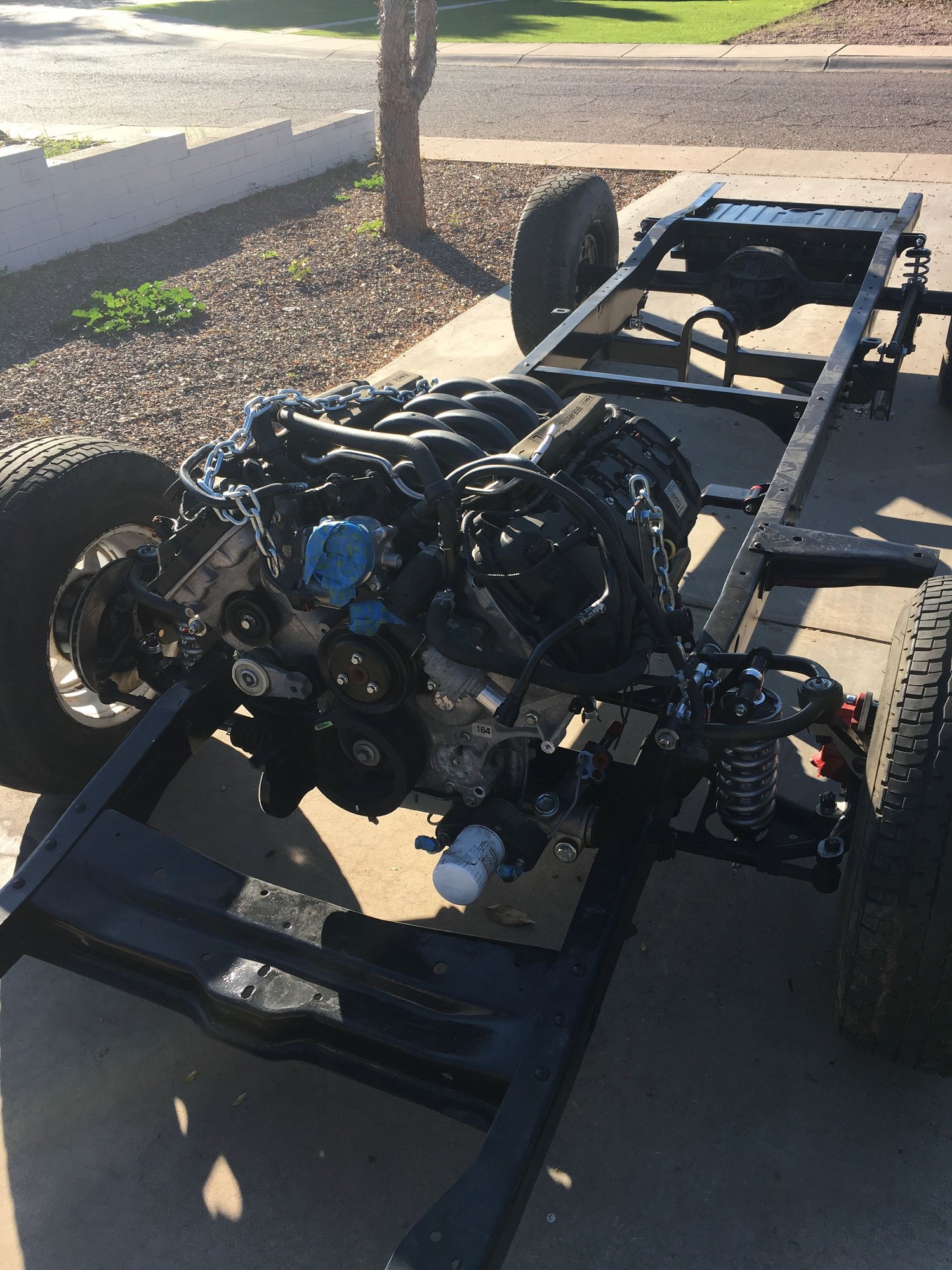

Hey guys. I haven't posted in a while, but have been doing a lot of work. I welded the suspension in, and painted the frame. It's been fun welding in AZ during the middle of the summer. I am starting to place the motor in, and have some questions for the folks who have put a motor in a truck it wasn't intended to fit in. If you take a look at my pictures, just wondering what you guys think. I know it's best to get the motor as low, as far back and as centered as possible.
I got the oil pan that helps with the coyote swaps and it works great. But, my power rack is now preventing me from going very low. Wanted to get your thoughts on the following.
1. How low should I place the motor. You can see in the pictures the oil pan is sitting flush with the cross member, but I can only come down maybe another 1" due to the power rack.
2. I have a thought about lowering the power rack by making new brackets to bring it down, leaving me more clearance. Or lowering it as far down to leave space between the oil pan and the rack and then making a new cover inside the cab to cover the trans.
3. Is it acceptable to offset the motor toward the passenger side a bit? Would like to make a little extra room for the steering links.
I don't have a radiator yet, but am thinking my clearance should be good. And the only other thing I am foreseeing is whether I can get a floor mounted shifter (Planned on using a Lokar), my drive shaft may hit the middle crossmember which I can cut it out and make a new one that can clear it. Other than that, the headers clear and don't hit the frame. Hoping to get the motor mounts in within the next week or two and have it a rolling chassis with the engine sitting in there.
Looking forward to your help.
Here you can see the trans just below the cab.
Just a side picture showing how the motor is sitting where the oil pan is almost flush and obviously the trans is a bit lower without the angle actually set. Going for about 3-5 degrees
This is a picture with the motor mount. I am trying to get the motor mount closer to the cross member so I can use it to mount the tubular motor mount. I can go forward a bit, but the may run into clearance issues with the oil pan.
Trans sticking up in the cab
Other side showing the rack
A front picture.
And here's a picture of how close I am to the power rack, but can certainly get the oil pan lower and let it get closer to the oil pan.

Looking good . Lots shift the engine a little for steering clearance , the lower the less chance of firewall issues but do not drop your rack . It can cause bump steer if it is not in the proper position .

Thanks for the reply. Forgot about bump steer. I was trying to keep it as far to the passenger side as possible, but have the fitting for the rack there. I removed the line because it comes up and to the right, which will cause issues with the oil pan. I am going to make a new line that comes out and to the left, then back to the right where it needs to connect to. You can see it in the picture.

Hey everyone. I haven't posted in a while, but I have made a bit of progress. I finished up all of the suspension bits, installed the engine and trans mounts and have the motor in. I am figuring out what I need for the Fuel system, brake lines, and will then have the exhaust made at a local shop. I am also starting on the cab to get the repairs done so I can get it back on for good. There is a lot to still figure out and a long way to go, but it's coming along.
