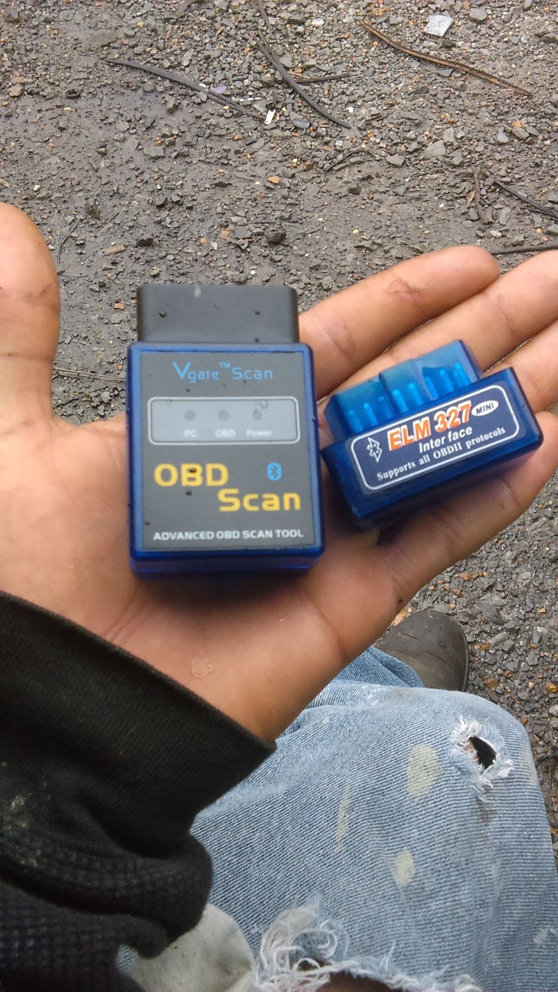

When I connect my scanner it say unavailable to connect to the ECU. In yes the power up in light up.

I have a Bluetooth scanner

When you plug that left one in do any of the lights on it light up? Do you have another vehicle you can try them it to see if they work at all?

Yes the light come on. I tried it on other vehicle and it it worked. On my f250 the check engine light is on and it's saying no codes when I do it
