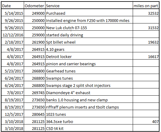

Here is a list of some of the things I have done to the truck over time to paint the whole picture. The mileage is calculated from my last fuel fillup so actually have about 500 more than it says. Clutch seems ok to me. Actually has just over 33000 miles on it. Truck had a hydra with the canned PHP tunes from day 1 usually the 60 or 80 setting on stock injectors. I try not to slip it taking off or backing up. When shifting I make sure it is in gear and my foot is off the clutch pedal before I push the skinny pedal to the floor. so yes I use my truck hard but try not to beat on it if that makes sense.
