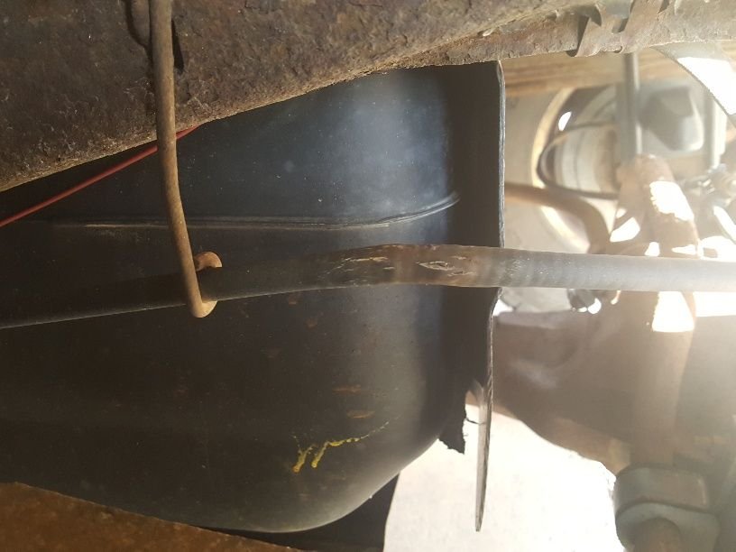

I found this metal hose line that is cracking. I haven't checked to see where the front end of it connects to, but it ends at the rear axle. My truck manual is packed (I'm in the middle of moving) and I can't find out what the cable is online. Any help is appreciated.

That's a parking brake cable in the top picture. There is no fluid in that just the inner cable. The Lower picture that's the hydraulic brake line and Axle breather.

Oh cool. Then I'm not in danger of some mishap of vital fluids leaking if/when that metal hose blows through. Good to know.

Two things I see. Top pic is the parking brake cable. It looks like it is rusted so be careful trusting it to hold when applied. It should be replaced soon. The other is I see a flat spot worn on the hydraulic brake line. Not that bad but you need to get those other hoses away from it to avoid rubbing through. JMO..

What about that red wire in the top photo? Looks like that needs attention.
