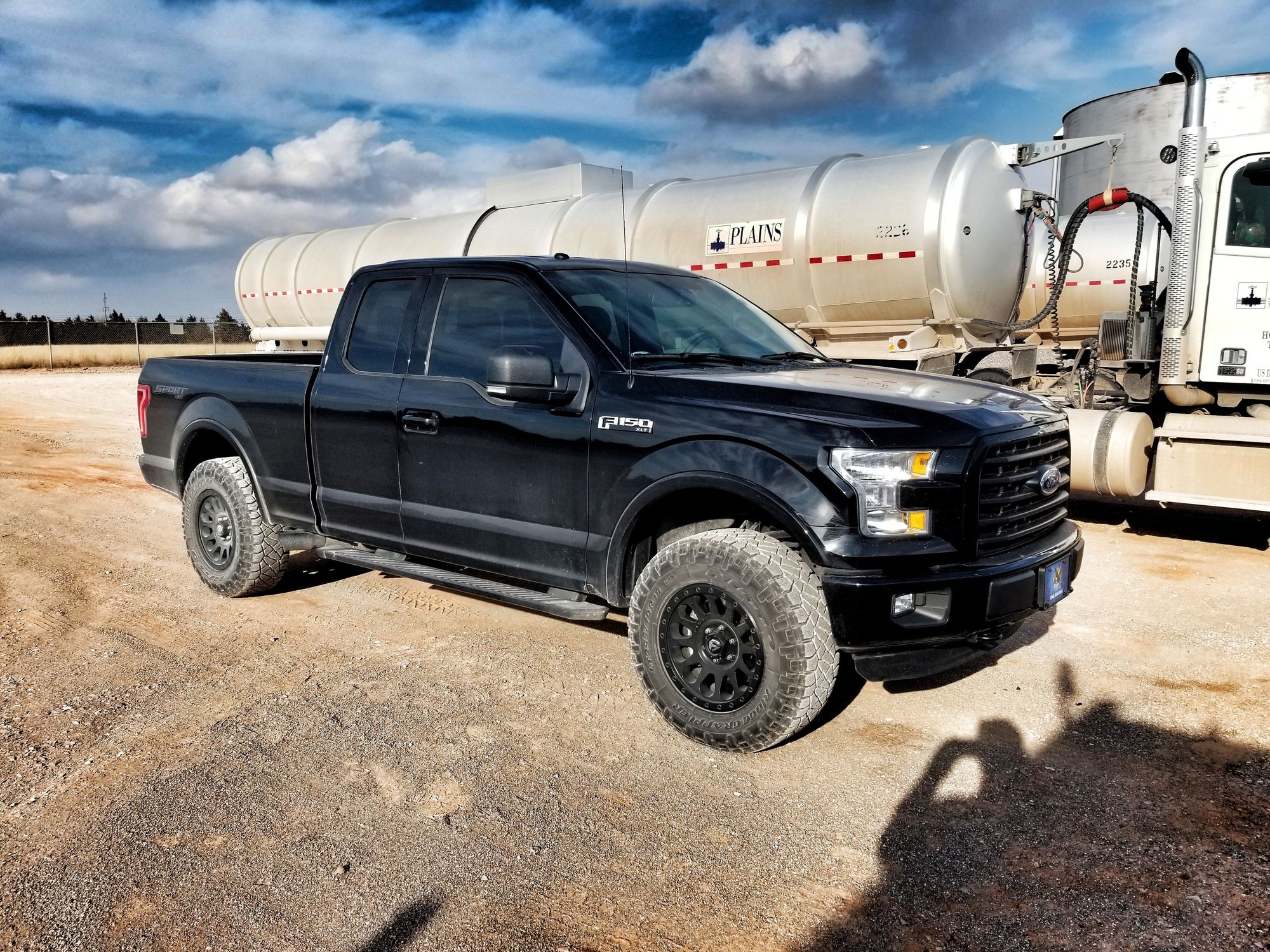

I bought this truck last December and against my better judgement, bought it already modified. It had on it when I bought it an MBRP exhaust, leveling kit and larger than stock wheels and tires. 9X18" Fuel wheels with Nitto Ridge Grapplers size 195/70 R18. The rest of the truck is stock. Looks great and sounds even better.
The problem I have is terrible bump steer when I hit a decent size bump or pothole. I'm not talking about the death wobble, just hard sharp pull to either side of the road when I hit a bump at speeds above 40 or so. It's coming from the front end of the truck and I can feel it pulling on the steering wheel. It about put me in a ditch today.
What's causing this? My 02 FX4 never had bump steer like this execpt for a few occasions when I could feel the rear end hop around a little.
I haven't been under the truck to check out any of the components down there and I couldn't get a hold of the previous owner to find out if any other mods were done.(Which is why I don't like to buy stuff other people have tinkered with, but I just got too good of a deal on it.)
Is it the tire size? Maybe the shocks vs. the leveling kit? Electric steering issue? Sway bar? Any suggestions are appreciated.
