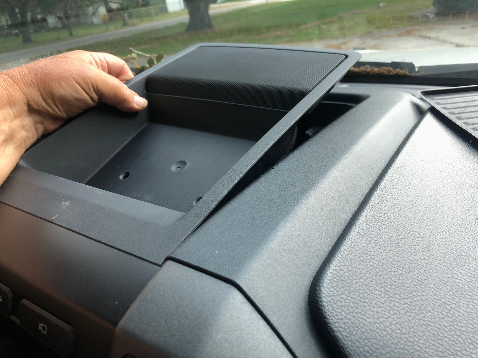

How does this panel get removed? Rear edge pulls out. How is the front attached?

i believe you need to pull the bezel from around the radio or sync display to get to 2 or 3 7mm bolts

Just pry the bezel off? Need pictures of where the bolts are please.
Just pull it straight up. The bolts under it are for removing the radio bezel.

Search YT for F150 videos 2015 up on radio removal. Think it's the same seup as your truck. If memory is accurate the panel you have partially removed covers 2 screws that holds front bezel on son don't pry on front bezel! Don't remember precisely but the vid makes the sequence very clear.

I solved it! Just pop the panel straight up! It just snaps in place.
