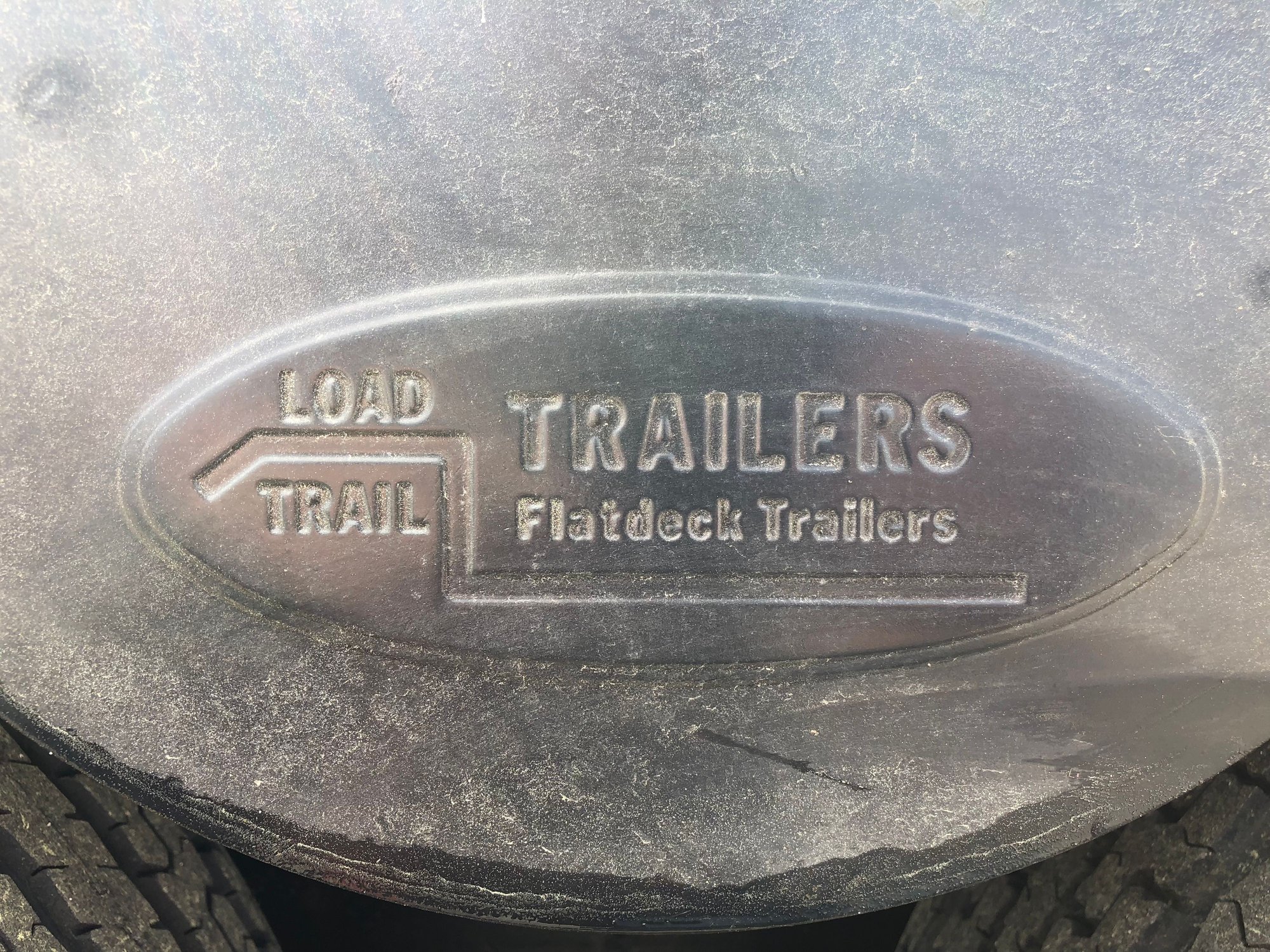

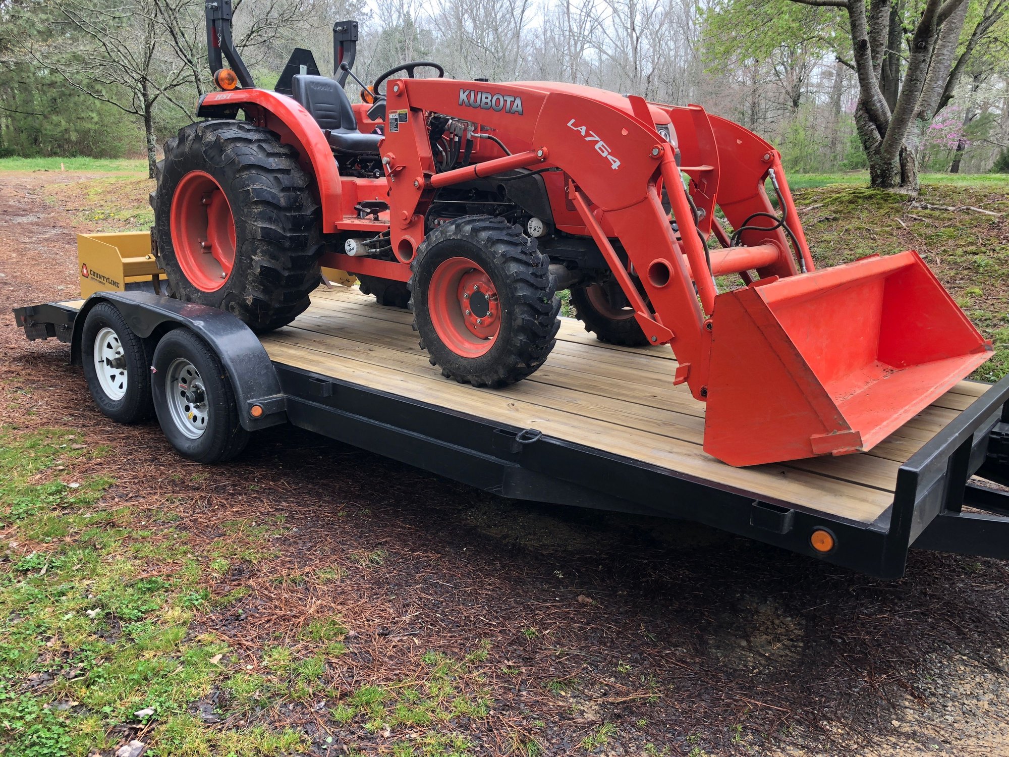

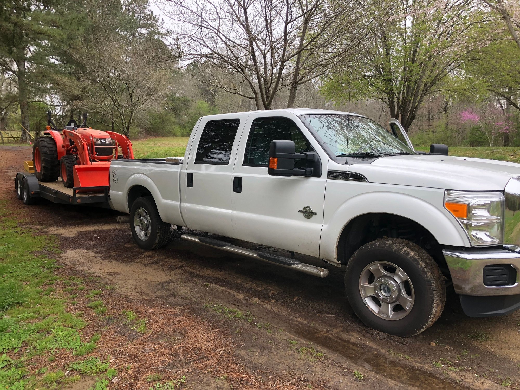

What trailer do you have?
Old Mar 19, 2018 | 03:01 PM
drewsky121's Avatar
drewsky121
Joined: Mar 2018
Posts: 7
Old Mar 19, 2018 | 03:02 PM
drewsky121's Avatar
drewsky121
Joined: Mar 2018
Posts: 7
Old Mar 19, 2018 | 03:14 PM
drewsky121's Avatar
drewsky121
Joined: Mar 2018
Posts: 7
see the pictures, it’s just a standard car trailer as far as I know. Single rear axle brake system.
