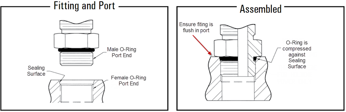

Check your HPX adapters that screw into the head. I just put new rings on friends truck a few weeks ago that didn't seat them all the way and the oring leaked.

Oring failed on the HPX.. weird because I was very careful when installing... anyone know the oring size for the rifraff HPX ?

-905 viton 90a

They are -5 orb (o ring boss).
