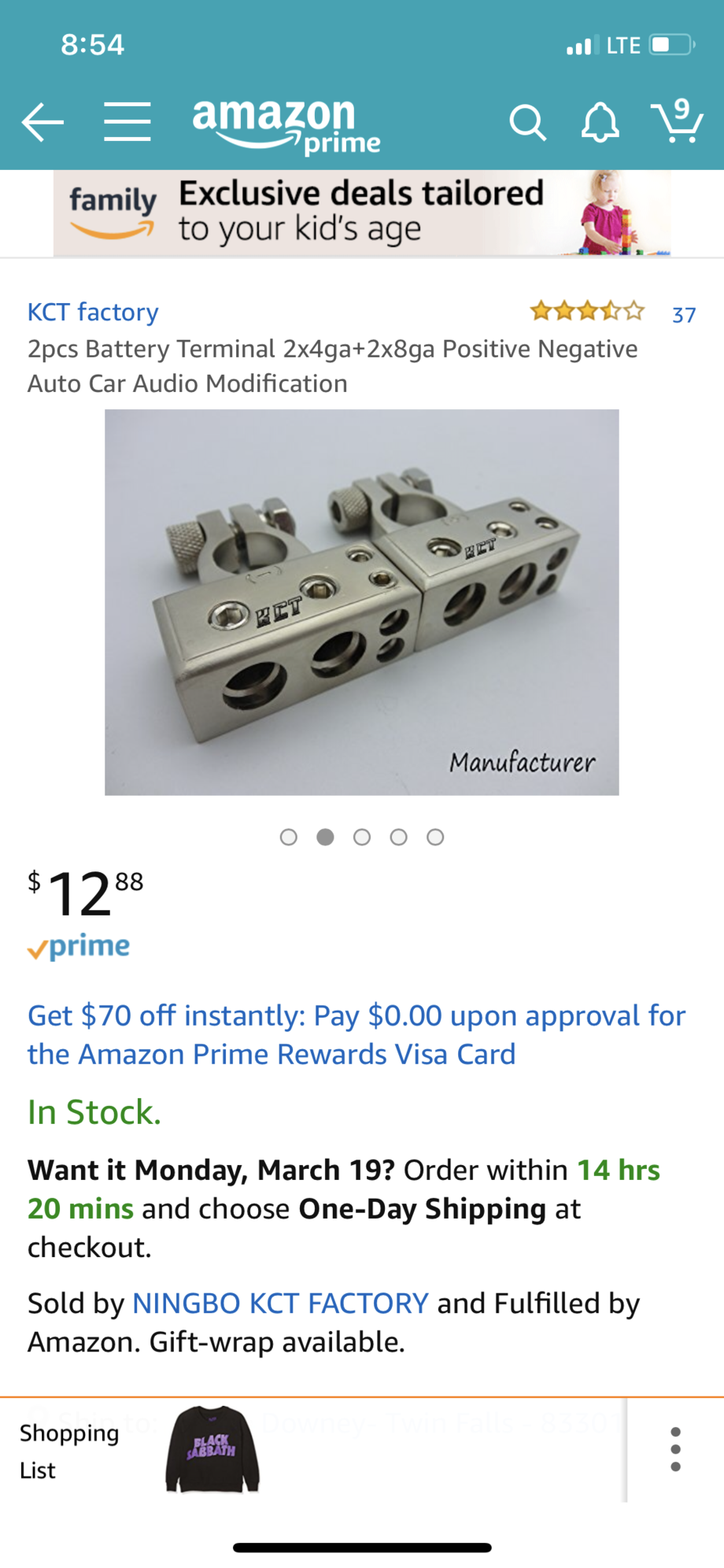

As far as battery I have a bad connection of grounds to it. Due to clamp issues. Went to get one and the local store I work with is out of stock. SO I ordered thicker insulated pos and neg wires with new connections. Should have Sunday.

Updating the old connectors.
Nice and clean looking.
