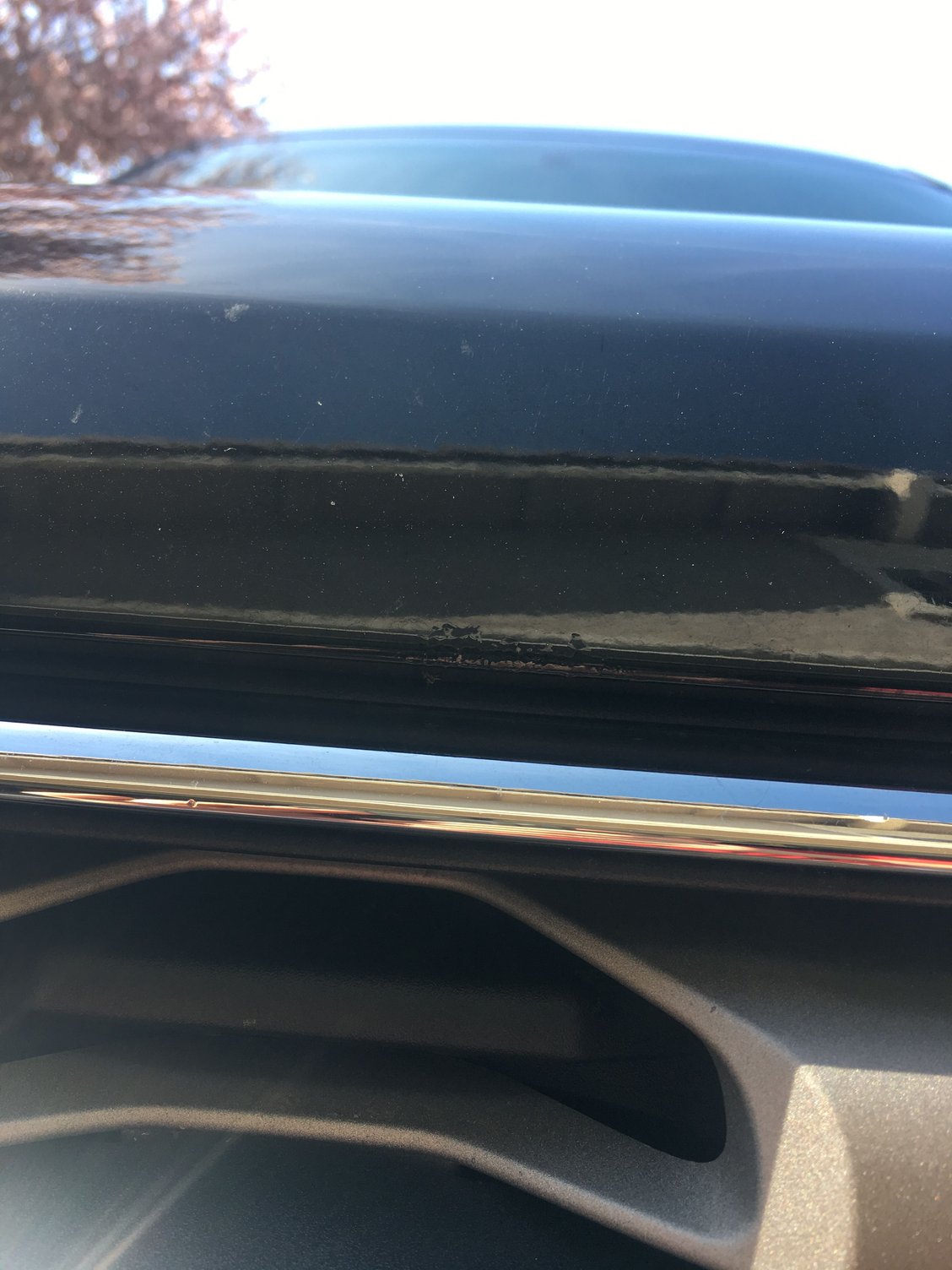

Noticed the paint bubbling up and even chipped off in a few areas on my hood; leading edge. Looks like corrosion underneath. Is this something that is usually covered by the factory warrantee? It’s a 2016 Black Explorer XLT. The hood appears to be aluminum as there is no magnetic attraction; the corrosion is the white powdery stuff you would expect from aluminum.

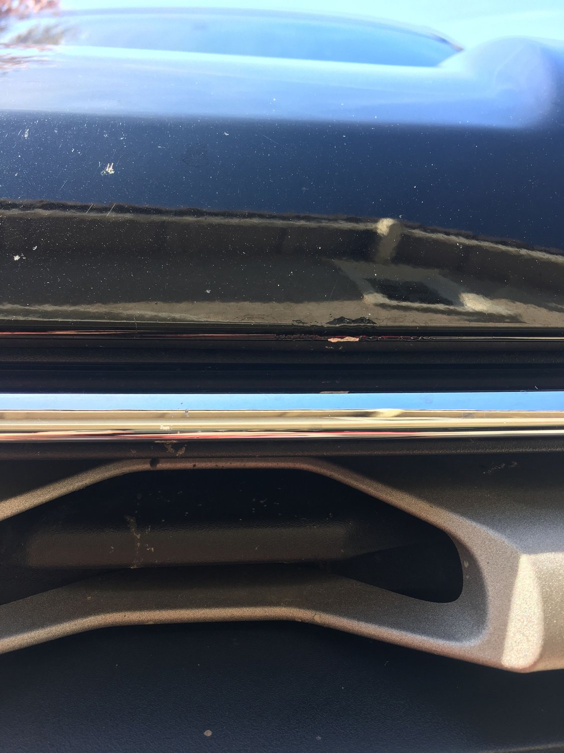

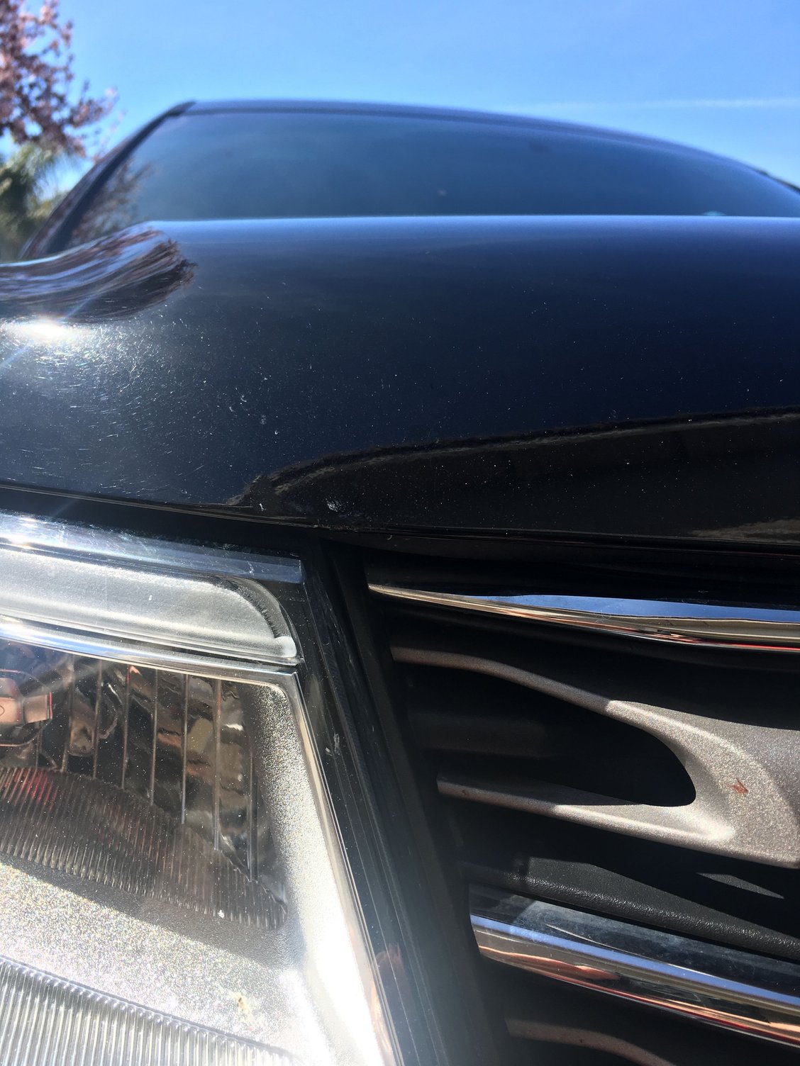

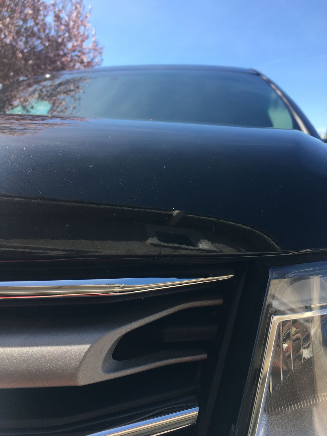

Here are a few pics. In the earliest stages but definitely noticeable. With only 6k left on the warrantee I need to go get this addressed ASAP.

Some of these might be harder to see than others...

This is an ongoing problem with Mustangs, Explorers, and Expeditions (prior to the 2018 redesign of the Expedition). You can see in Consumer Reports ratings on these models that after a couple years, the paint is rated as having "much worse than average" problems.
There is a TSB on how to prepare and repaint the hood and/or tailgates where the metal has to be ground down to bare metal, not contaminated with any iron particles (which is the source of the problem), prepped with a special primer.
If you are under 3 years and 36k miles you have a better chance of some kind of settlement. Ford did change their rust warranty to include aluminum "corrosion" in 2015, presumably because of the aluminum body on the F150, and it does not require holes in the aluminum to be considered a legit problem Point to this language in the rust warranty, go to multiple dealers, and escalate if you have the patience.
I had considered an Expedition and this problem is one of the reasons I crossed it off my list. The problem has existed since 2003 and it is pitiful that Ford cannot do better. Many brands of cars (including other Ford models) have aluminum hoods and tailgates and do not have this problem. They apparently let paint companies set up the spray booths in their factories for these vehicles and in addition to iron contamination, do not spray the paint with adequate thickness.
I'm a major Ford fan but this is corporate incompetence at work and Ford does seem to understand the value of keeping customers happy if they want them to continue being Ford customers.
