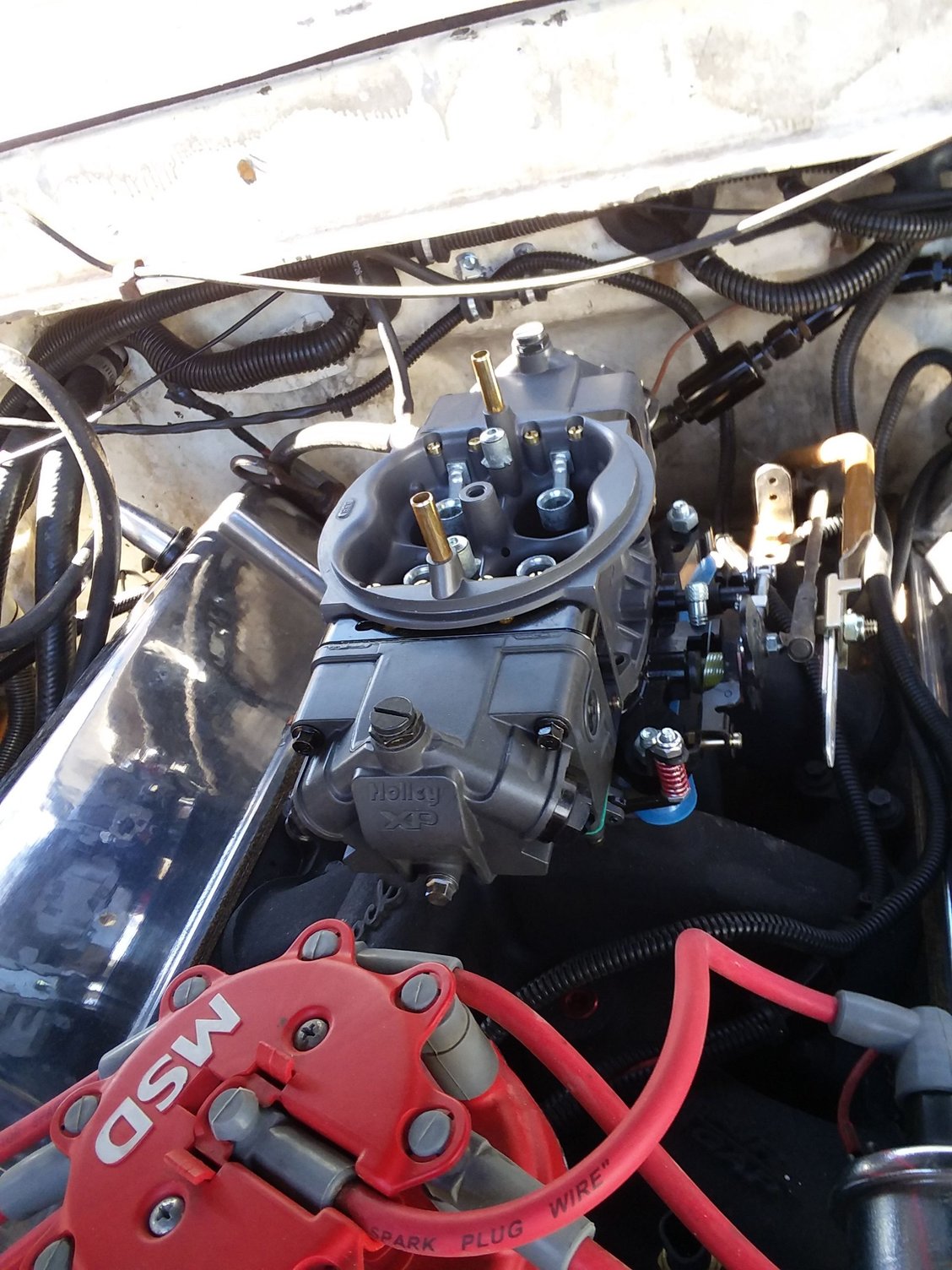

Fitech issues finally resolved
Fixed.

Not what I was expecting, LOL. That is one way of solving it...
What problems were going on with the Fitech?
