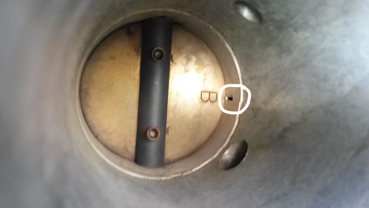

You don't mention if the vehicle has EFI or carb, one tank or two. I suspect it is EFI. If the pump inside a tank is bad, the vehicle can die under the condition you describe, slowing down or coming to a stop. if that's the case, in my own experience, it usually will not restart. However, I have two tanks. I just throw the switch and the fuel system primes right up. (the pump in my rear tank is weak but runs, the front tank pump works fine) Again in my own experience, when my 5.0L EFI truck dies under those conditions, it may be found to have a fouled throttle plate air bypass on one or both throttle bodies. (see pic) This condition is usually coupled with a stumbling idle before it actually dies. The fouled bypass is very easy to remedy. Just spray them clean with throttle body cleaner.
These EFI fueled engines are notorious for fouling Idle Air Bypass vales too. These valves are also pretty easy to thoroughly clean. Removal is required though.
