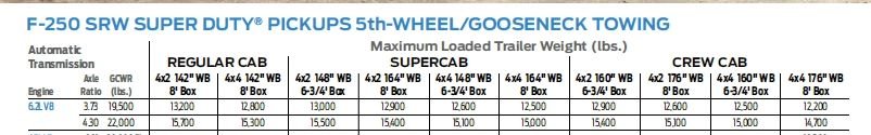

I have a 2017 F250 XLT with towing package 6.2L . Specs say the truck is rated to pull a loaded trailer with a weight of 12500 Lbs. Would I be crazy to pull a loaded trailer with a weight of 14500 Lbs. I'd be doing this about 6 times a year from spring to fall.

This would be a 32' gooseneck trailer with 2- 7000Lb axles with electric brakes. Mostly Hwy driving. Load is 2 modified jeep wranglers.

If you have the 4:30 gears, you'd be within spec which I'm assuming you don't. Those two wranglers weight that much? Or heavy trailer and gear too?

An F-250 has the same exact frame as an F-350 dually, and likely a 450 pickup as well. Same brakes as a 350 dually. Same front axle as a 350 dually. Same rear axle as 350 gas of this generation, or a 350 diesel of the previous generation. So the basic platform is perfectly capable. Your problems are essentially rear suspension and engine power. A 250 has a max GVWR of 10k, which...when you subtract out the trucks curb weight, leaves less payload than a 350 SRW (essentially the same truck with stiffer rear springs) that has a GVWR of 11,400lbs. The payload on a 250 is less, which is a limiter on towing based on tongue weight alone. Then there is the 6.2L. Perfectly capable engine, but pulling 14k with a gas engine is going to be a struggle on hills. I wouldn't say you are crazy, but if you can't keep the speed limit on hills, make sure to put your 4-ways on when going up the hill.

I second what troverman stated about the trucks basically being the same as far as frames axels and brakes. Except, I wouldn’t worry for a second about the 6.2 not being able to pull a 14-15,000 pound trailer! Axel ratio makes a big difference and I don’t know what axels are in your truck but I have 4.30’s and pull that kind of weight all the time without a problem. Plus I have a few thousand pounds of tools,fuel and other crap in the bed of the truck too. I did the same things with my old 2011 that had a 6.2 with 3.73 axel ratios but the 2017 does it better.

A 2017 F-250 diesel crew 4x4 will tow 17,600 if you opt for the high capacity tow package. Both RAM and Ford have roughly the same payload capacity on a 3/4-ton diesel crew cab, and Ford offers the same tow rating with either 3.31 or 3.55 axle on the 250. Ram offers only a 3.42. The reason for the towing difference is max combined weight rating (GCWR) which Ford rates lower unless you opt for the high capacity tow pack.

Like I said, I wouldn't call him crazy...just be prepared to go slow up the hills, especially with the 3.73 gears. I've pulled 10k with my 3.73 gas truck...up steep hills, it was...slow. But that's OK.

I'm curious where your're getting your information. If you read the towing guide the SRW PS trucks top out at 18K bumper pull and over 20K gooseneck/5th wheel. For licensing purposes you can get a de-rated SD that would pull less.
