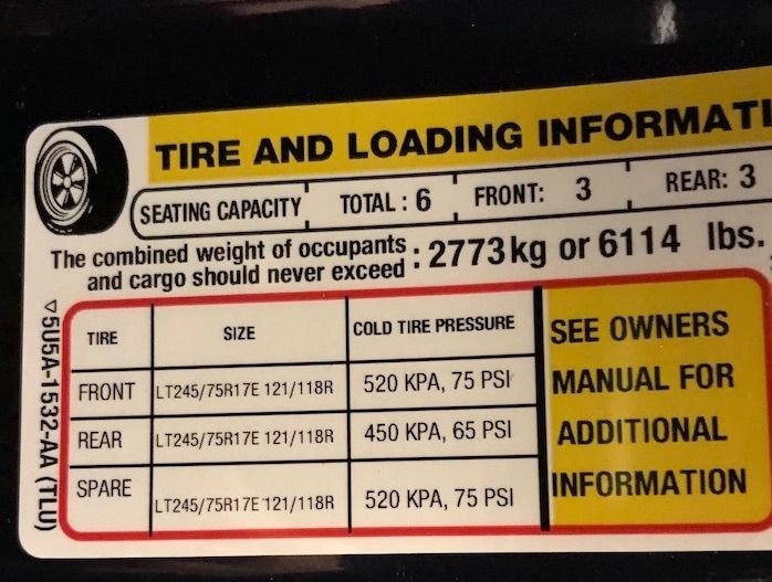

Originally Posted by bitNine
My current truck is a '16 Ram 3500, very well-loaded (including heavier Aisin transmission), and all the SD 350s I've looked at have payload ratings about 400lb under my Ram, which has 3840lb. Most of the 350 Lariats I've seen are in the 3400 range, though I've only glanced at 4 or 5. I guess I'll have to take a closer look today when I head to the dealer.
Really? Here's what my SD says for payload:
