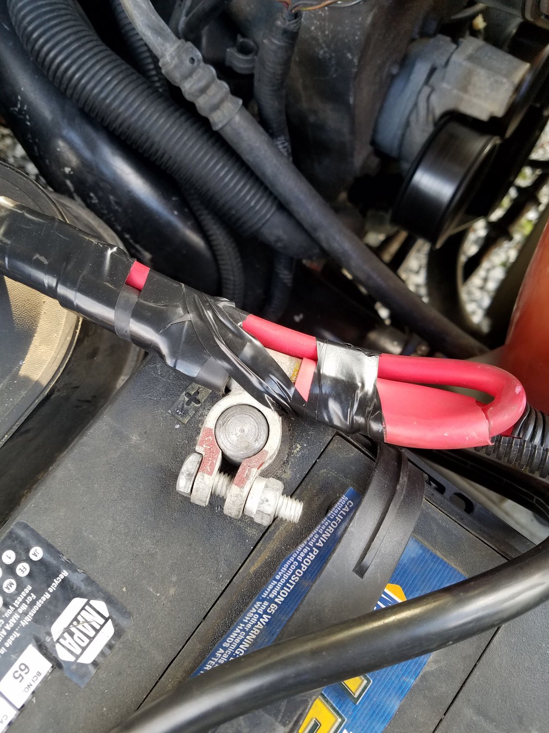

Originally Posted by schlepprock250
Well I guess my question was unnecessary, he just called and said he had them finished.. Just like the factory harness. Thanks guys
If you can take some pictures and let us see what kind of end are on them that would be great.
Old Mar 5, 2018 | 06:13 PM
schlepprock250's Avatar
schlepprock250
Joined: Mar 2008
Posts: 2,975
Likes: 19
From: Archdale,N.C.
Will do. I dropped them off yesterday, he built them today. I won't pick them up until Saturday but when I do I'll post up some pictures.

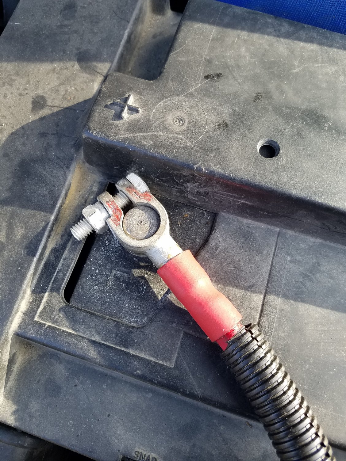

Old Mar 6, 2018 | 07:12 PM
Stebs's Avatar
Stebs
Joined: Jul 2012
Posts: 575
From: Eastern KS
I just upgraded all of mine... 2/0 between batteries and 3/0 to starter, 2/0 main grounds with 4 gauge to fender and frame on the passenger side... here's the drivers side ends...

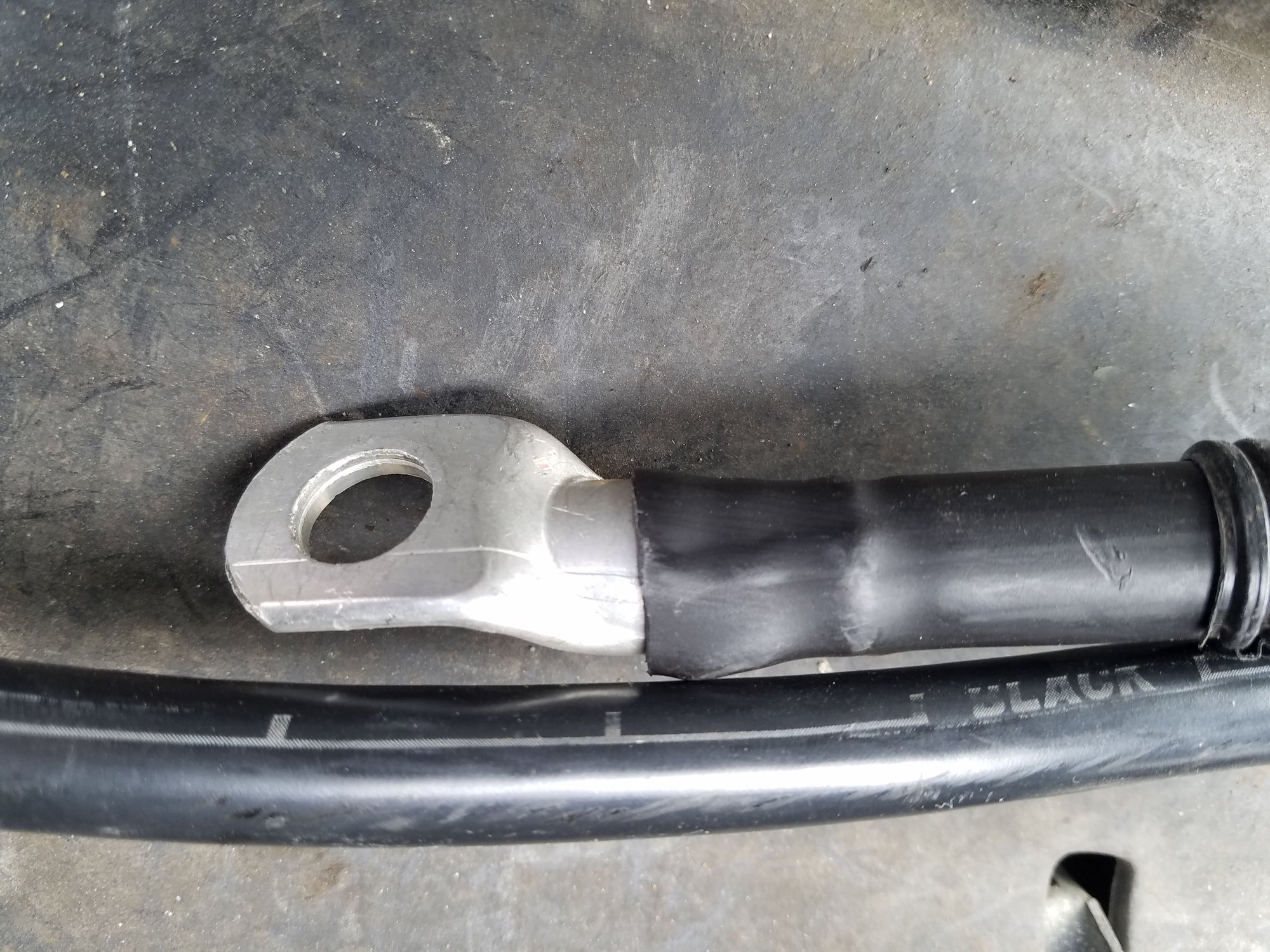

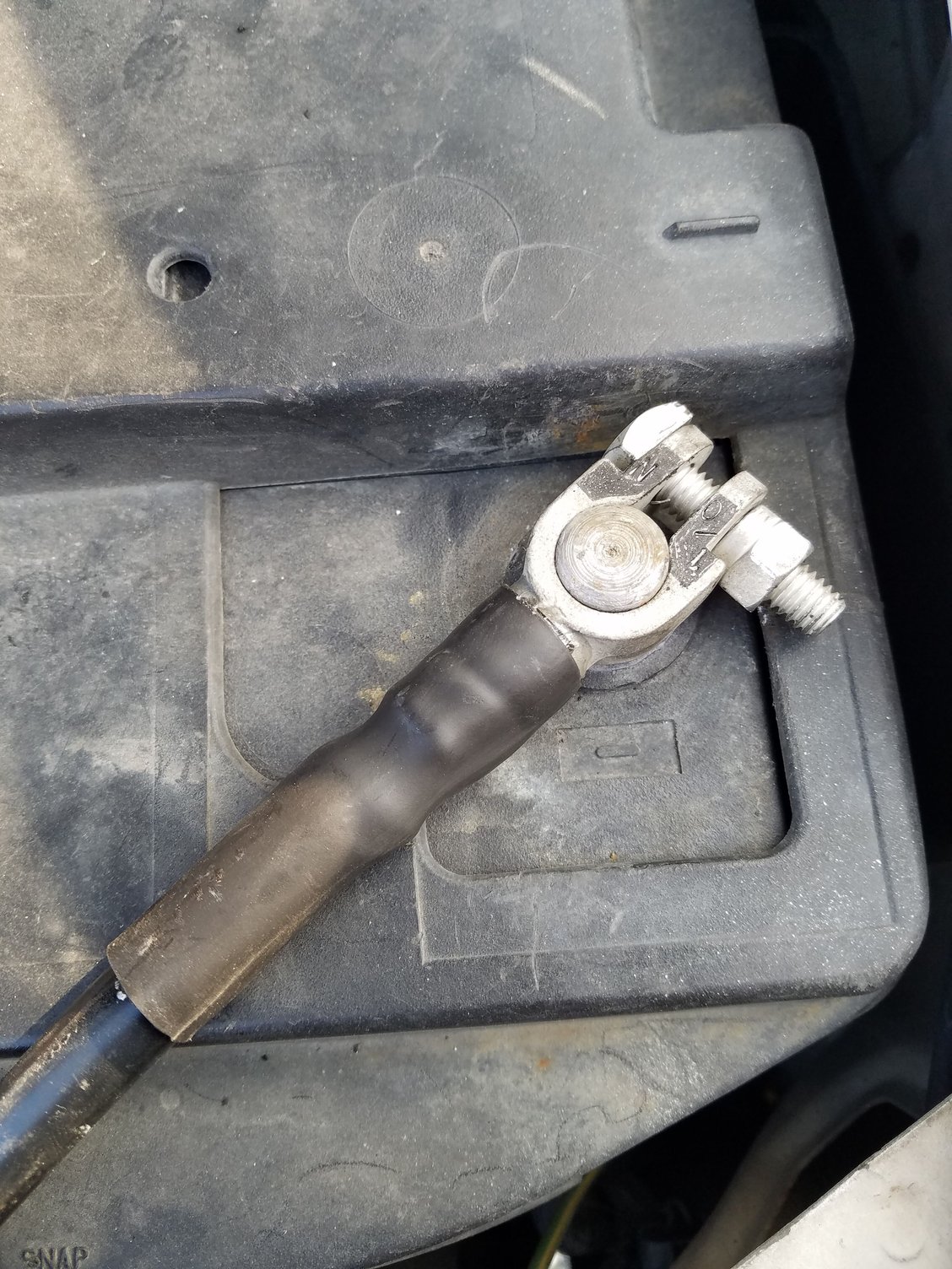

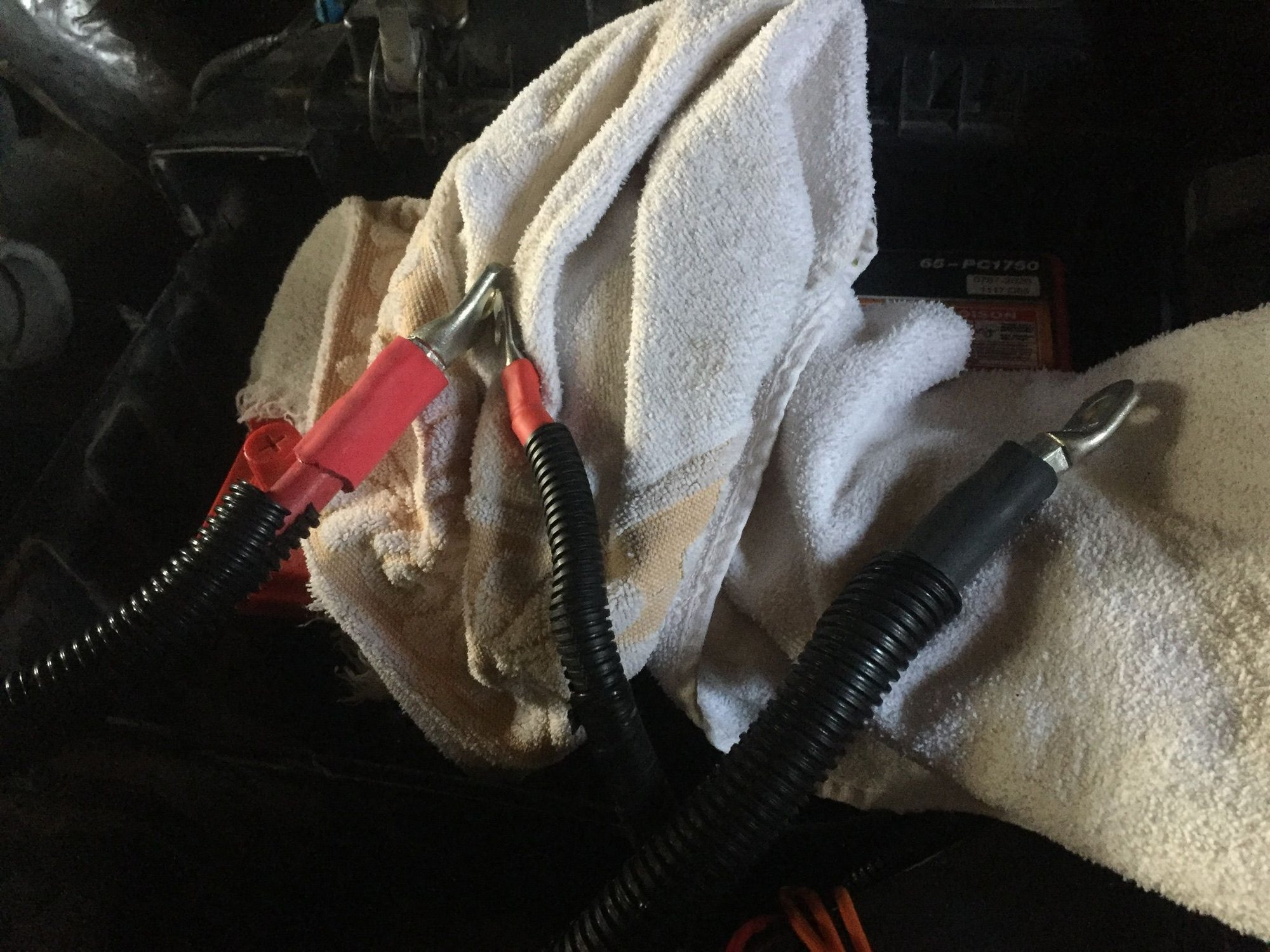

Here's a few pics. I didn't get one of the whole positive cable. They're crimped soldered and have the heat shrink that has the glue inside.
And to address my original question the cable from passenger side down to the starter is huge. He built them exactly like the stock cables, just with better material.

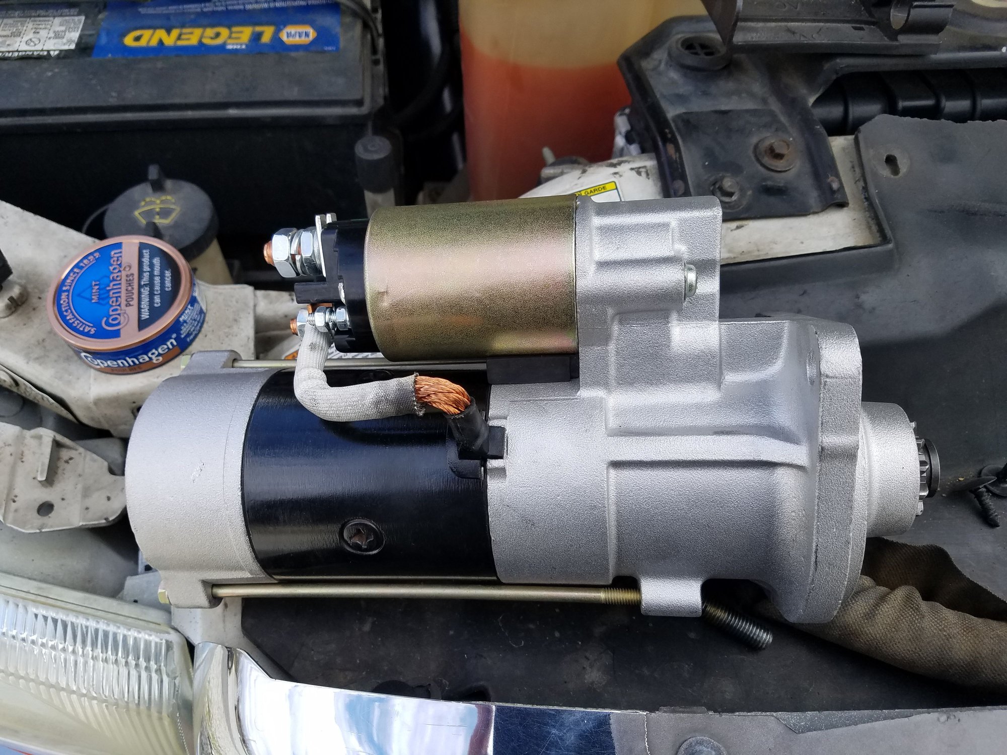

I also replaced my wonderful reman lifetime starter from the Irish store... For the third time in a year. I think I may have a keeper this time though. It spins it over faster than either of the other two. It actually spins faster than it ever has before. But I told my wife this is the last one I put on. If this starter slows down I'm putting a Denso on it.
Old Mar 8, 2018 | 08:32 PM
Stebs's Avatar
Stebs
Joined: Jul 2012
Posts: 575
From: Eastern KS
Part of the reason that starter spins over faster is your new cables and ends..
Probably some truth in this. I'm ashamed to post up a pic of my old cables /ends lol. But having a good connection at the local Irish store I went ahead put a new starter on it.
It actually spins as fast as the Denso in the video floating around. I may get a vid tomorrow and show.
And to address a related issue I just ordered a Stancor gpr.
