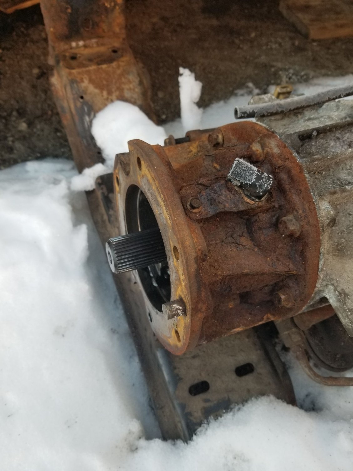

Hi guys I'm new to this site and I'm doing a motor sawp on 2000 EX 7.3 I've takin numerous transmissions out of the superdutys and never seen these. There is a adapter on tail shaft of transmission that the transfer case bolts to. There is a gear in the adapter what is it for? Thank you in advance

got pictures?
4R100 on the 5.4, 6.8, and 7.3 is identical to the 99-04 trucks (besides bellhouse pattern lol). the trans is completely interchangeable

Sorry it took a while when I got home it was dark. I talked to a friend and he said it was out put speed sensor. Didn't know anything else about it. I'm taking motor and transmission out of a 2000 f350 7.3 will that adapter bolt to the transmission I want to use? And is there seals or gaskets I should replace?

Yes and yes

Ok thank you. I'll get those from ford. Is there a bearing or anything else? All my other trucks don't have this so I've come across them before
