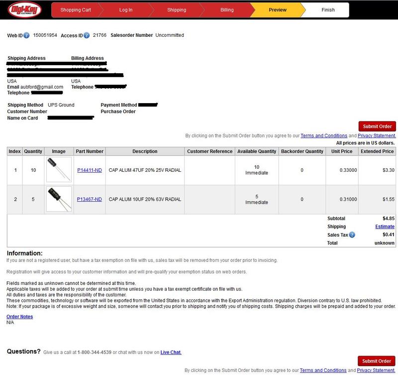

You could have taken out the caps as they need to be of a much higher voltage rating than 16v.
You should have two caps of 47uf 20% @ 25v & one at 10uf 20% @ 63v.
My last order for the caps, note my order was to more than one PCM.
Attachment 285063
