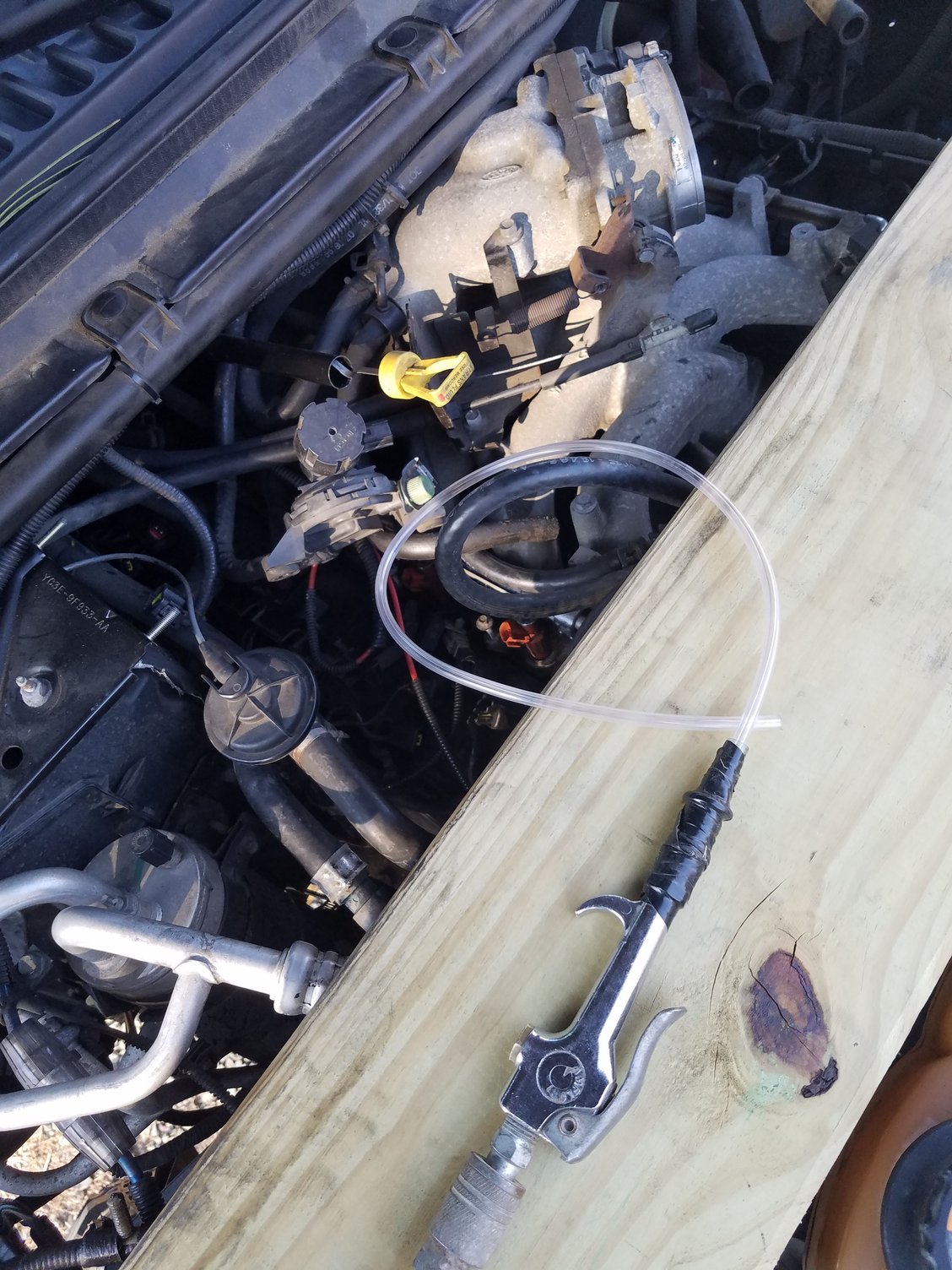

I did make a nifty air blower from some surgical tubing and compressor air blower attachment. has really proven to work well in clearing head crevices of debris prior to pulling cops out. i will post pic of later.
thanks for your help. God Bless and Semper Fidelis.
field expedient blower. cleans around plug holes great. O2 tubing, electrical tape and air nozzle for compressor.
