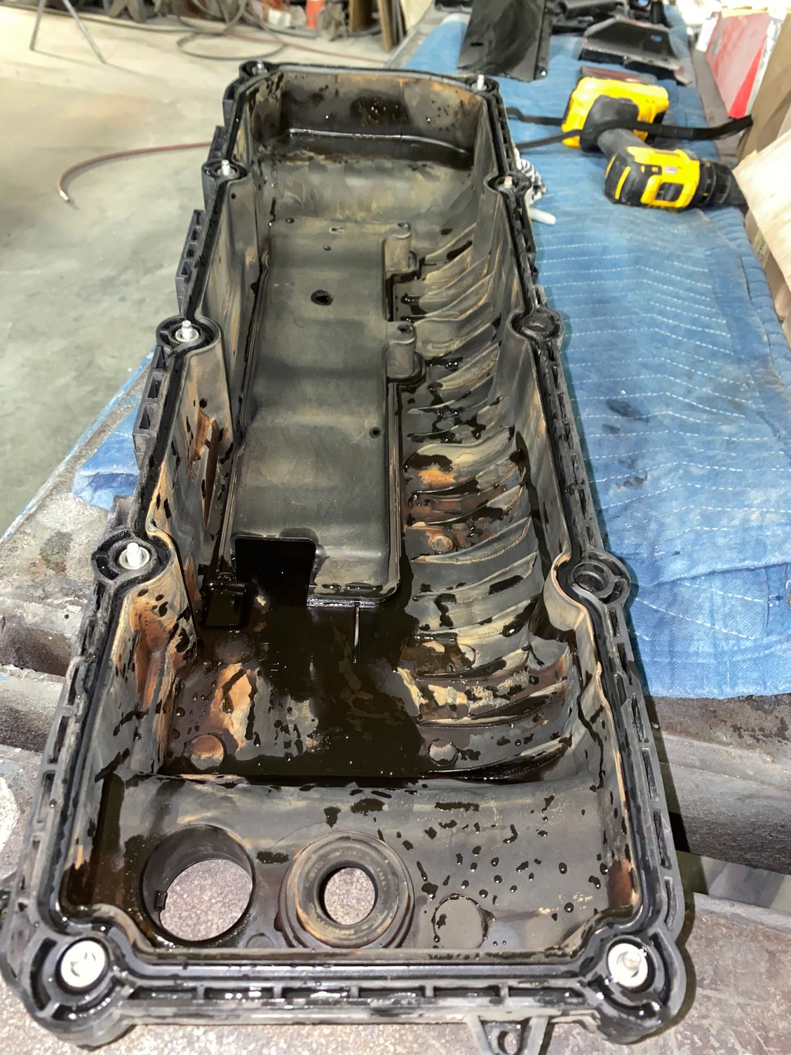

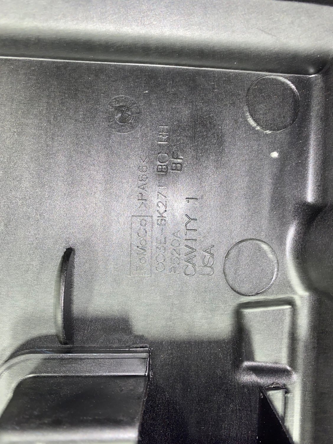

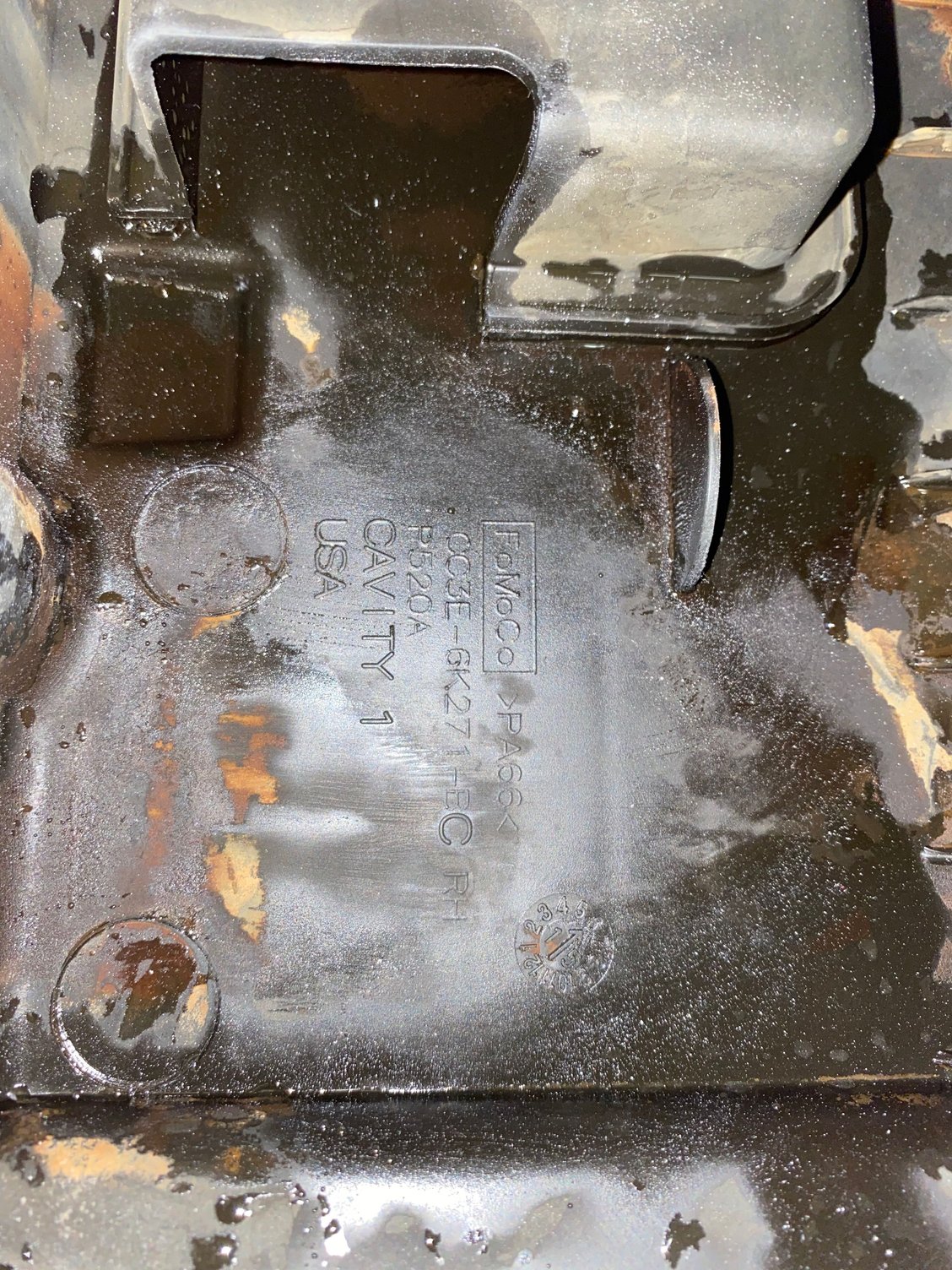

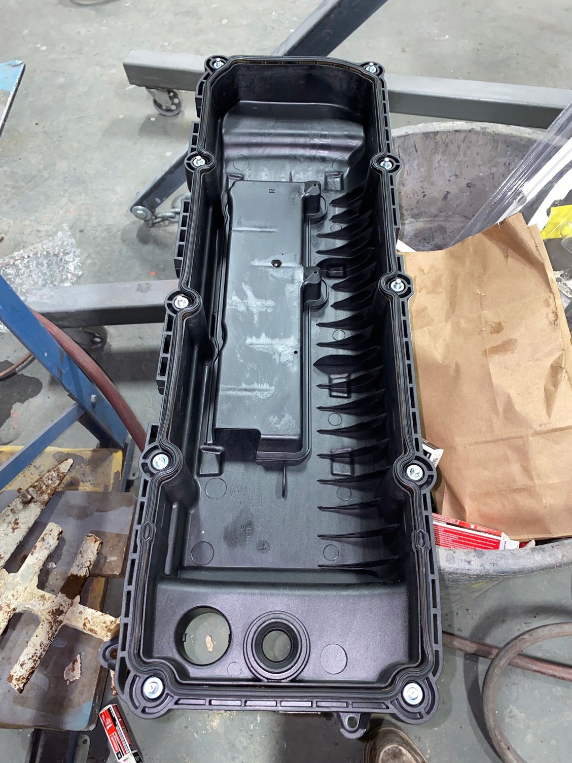

Just wanted to post on here for anyone looking into the oil consumption problem on the 6.2 gas motor, I researched this problem a lot and finally went to get the “updated” valve cover ford put out with its TSB on the oil consumption problem with the effected years 6.2l. Long story short the “updated” valve cover is exactly the same as the one that is in the truck already, absolutely no difference. I got my valve cover off and compared the two to actually find that even though they changed the part # on the box (which they’ve done 4 or 5 times with the same valve cover, I found this out by talking with a close friend of mine who works the parts counter at ford) the part number stamped on the inside of both valve covers were exactly the same, after cleaning mine I could see there was actually nothing wrong or broken about it. Essentially what is happening is the oil is getting sucked up through the pcv because it’s not draining from the baffle like it should before reaching the pcv at the end of the baffle. So seeing that ford has no real fix for the problem I drilled a large drain hole in the center of the baffle before reinstalling the cover. Also did replace all 16 spark plugs as the TSB calls for and I found the lower 8 we’re all in very bad shape and covered in oil, upper 8 were clean but I replaced them anyway..... Will have to wait and see if my drain hole actually works, my truck was consuming 1 quart every 1500-1800 miles. I will include pictures of the old and new cover so you can see there is no difference.... and I can say I know for a fact the valve cover in my truck was not defective, it was just a bad design from ford, also the pcv on the effected side was wet with oil, other side(drivers side) nice and clean.
New “updated” cover
“Updated” stamped part number on inside of new cover
Old cover, the rust is just from the reused parts cleaner, I hadn’t wiped it off yet , notice my drain hole up the other end in the center of the baffle
Old stamped part number on inside of cover, same as the new one

Mine is a 2016, build date 06/15. If this doesn’t work I may just get a pair of the older aluminum valve covers from the earlier years, my last truck was a 2011 extended cab with the 6.2 that had the aluminum covers and that truck did not consume any oil at all, that truck also used 5w20, and the newer years like mine that got the new composite valve covers takes 5w30 which I’ve seen many threads on that as well... I will post back when I have a conclusion on whether or not my little modification to the baffle works or helps at all or not. If it doesn’t I’ll continue with finding a pair of the aluminum covers and if those don’t match up then my last thought would be to add a catch can, if there’s no way to get around the consumption problem catching it with a catch can would be better than recirculating it back through the intake. A big big catch can hahaha
