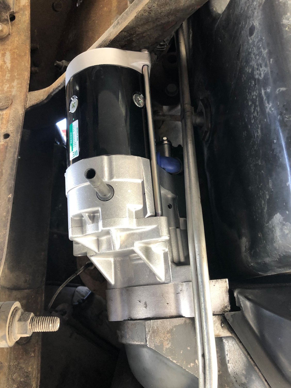

Thanks for the update, what's the tube sticking out of it?

For the ZF6 they were M10 x 1.5 x 45mm bolts. Brad used 40mm and I would assume the M10 is still the same, but might not be.
This is what the 45mm look like after mounted. Imagine the OEM 30mm in there, very drastic difference in bite between the two.
