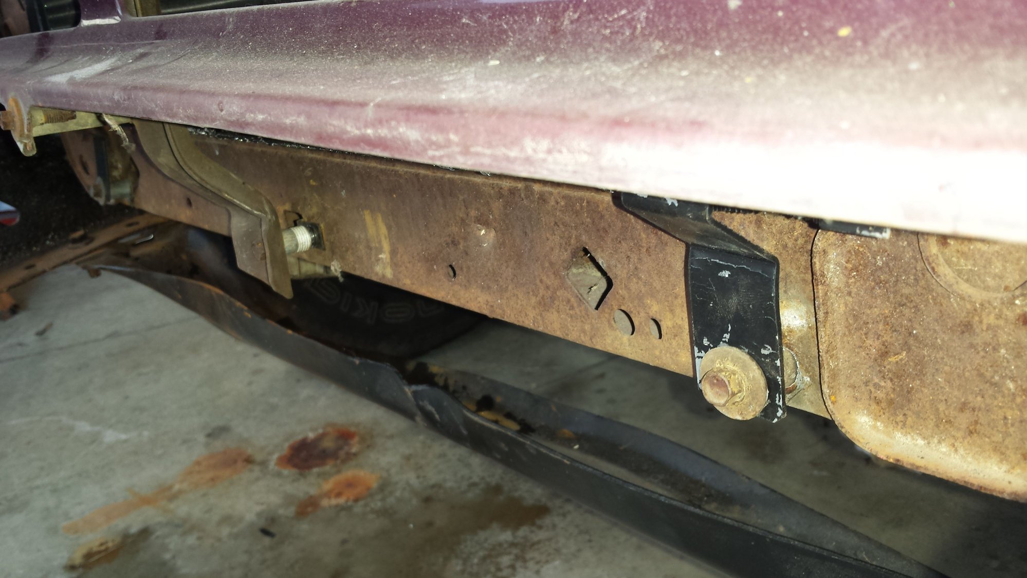

Sorry to say any condenser you get will need some work to fit.
I did not look over Karl's link but it may show what I am about to post?
The same part numbers were used for our trucks and the newer ones but is not a direct bolt in with out a little work.
The work is not hard at all.
You bolt the top in just like you would when replacing the part it is the bottom that needs work.
IIRC you have to undo the center grille & hook latch support at the bottom.
I made 3 think 1/2" stand offs using pipe as spacers.
Also found 3 longer bolts 2 for condenser and 1 for the support.
Put the spacer between the radiator support and condenser and bolt it down.
The last spacer is for the center support, spacer between support and radiator and bolt it down.
The rest should go back together like normal.
