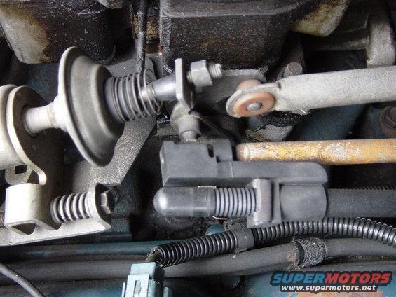

Your 85 AOD has a TV rod instead of a cable? (should have unless some changed it) It looks like the old kick down rods on the C6.
Sometimes the bushings will get brittle and break not just at the carb but also down on the transmission..
Like Conanski says check the fluid first.
bushing gone at carb
What is should look like
