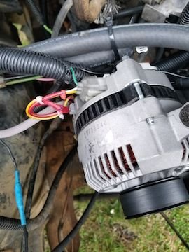

thought I'd drop a few photos...thought it might help.

I took the bracket system from a 96 302,so its serpentine.
the battery is two months old. it showed 100% charge.
its on its second regulator. (just incase)
It starts very smooth.

HOT DAMN!!!! I figured it out, or rather the muffler guy did for me. When I switched brackets I took out the C10 till I get the whole system done. This left too much play in the belt from the alt to the power steering. I put the old C10 on it and Its running and starting like a dream. I want to thank everyone that hung in there with me thru this process. May good deeds come back to y'all 10 fold. Thank you all. Now to the next project of a radio and alarm.
