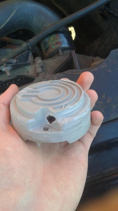

Originally Posted by kr98664
Got pics?
If teh rotor drifted up, you'd see scrape marks on its top edge and on the bottom of each post.
If the cap was off center, you'd see scrape marks on the side of posts adjacent to the damage.
Old Feb 21, 2018 | 08:01 PM
Franklin2's Avatar
Franklin2
Joined: Jan 2001
Posts: 56,984
Likes: 2,738
From: Virginia
Where is the metal piece on your rotor? Looks like that got wiped out and it got jerked out of the rotor and crashed into the side of the dist cap, making the hole.
Old Feb 21, 2018 | 09:25 PM
cgunning17's Avatar
cgunning17
Joined: Feb 2018
Posts: 45
From: Petaluma
Yeah the metal spring on the old rotor is missing. The old set blew up the day after installing them. I have the new rotor and distributor cap that I'm going to install later. I just want to find out the problem before installing the new ones and loosing them. Not looking forward to wasting another set.
