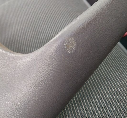

Firstly, I think I've resolved the gurgling issue in the heater core. I ended up adding about 1/2 gallon of coolant to the radiator and the noises have stopped completely. There's a lot more room in the radiator than it appears just by looking into the fill neck. I was really surprised by how much I was able to add.
Secondly, I had an opportunity to drive with my wife in the truck. She was able to pinpoint the source of the noise to the area where the dash meets the passenger side door.
After removing the inside windshield trim (across the top of the windshield), the trim piece along the side of the windshield and above the door and the kick panel, I discovered a lot of loose fasteners and a wear spot where the kick panel appears to have been rubbing on the door trim;
Kick panel:
Door trim:
Those two white spots meet and appear to show a wear pattern. So, I used a heat gun and ball peen hammer to push that area in some, on the kick panel. When I re-installed the panel, it was clear it had not been properly seated (due to vibration/age) and must have been rubbing on the door trim. Now that everything is back together and tight, I'm able to pass a thickness of corrugated cardboard between the two panels. I did not get a chance to go for a test drive however. So, I'll need to do that before I can consider this fixed.
