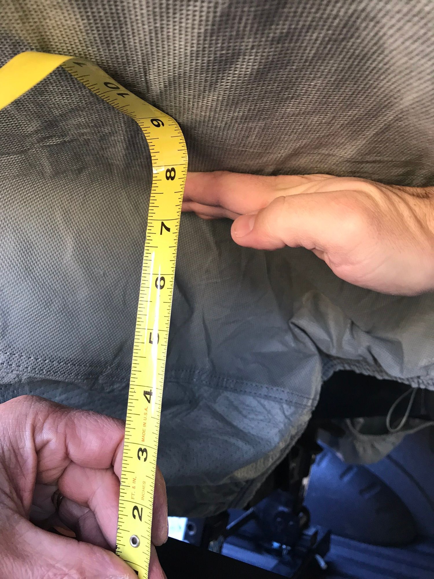

Adjusting fifth wheel to 2018 F350 4x4
Honestly it depends on your fifth wheel. I have a 2015 Grand Design Reflection 317rst, pin weight is around 2000lbs and UVW is 10,900lbs.
I worried myself to death over this same issue when I made the decision to go from my '08 F350 2wd to a 2018 F350 4x4 in early January. My '08 sitting next to the '18 made me think there's no way my fifth wheel will hook up to this thing, but I went ahead and pulled the trigger figuring I would have to lower the new truck.
My new truck came with the fifth wheel prep package, but I didn't want to purchase a new hitch right now so I ordered the Reese adapter to use my old hitch. I had a decent weekend not to long ago so I thought I'd get outside and install my hitch and start taking measurements. With the Reese hitch adapter installed and the fifth wheel hitch mounted, I measured the top of the hitch plate to the bed floor which came in at roughly 19". Since I had a 2wd the RV dealer raised my hitch one notch and lowered my pin box one notch previously at the highest setting.
Since my driveway slopes down, my fifth wheel parked isn't level (nose high). I started with measuring the front of the RV's distance to the ground and the rear of the RV's distance to the ground. The front sat 8" higher than the rear so I knew the front would have to come down 4" to sit level. I also measured my trucks front distance to the ground vs the rears distance to the ground. The front measured at 41 15/16" (we'll call it 42") and the rear mearsured 44 7/8" (we'll call it 45") so basically a 3" rake.
Before making any adjustments to the pin box or hitch I needed to know how much the truck was going to squat once the fifth wheel was hooked up. I also wanted to know how much clearance I was going to have between the bed rail and fifth wheel. To my surprise the front went down 1" to 40 15/16" and the back went down 3 3/4" to 41 1/8" with a clearance between the truck and fifth wheel at slightly over 8".
This tells me I can raise my pin box back to it's highest position. I unhitched the RV and proceeded to move the pin box and re-hitch. The fifth wheel was still nose high after new measurements by about 2 1/2" and I still had over 7" of clearance between the truck and fifth wheel.
My next step was to lower my fifth wheel hitch one notch which put the hitch plate around 18" from bed floor. I re-hitched and measured again. The fifth wheel ended up about 1/2" nose high with a truck/fifth wheel clearance of 6 1/2" and about 1/4" rake on the truck. The one thing I didnt' do was slide my hitch to the forward position shifting the pin weight above the rear axles, but I don't anticipate the measurements to change much.
What's kind of a pain is how high I have to raise the fifth wheel to park my truck in front of it.
