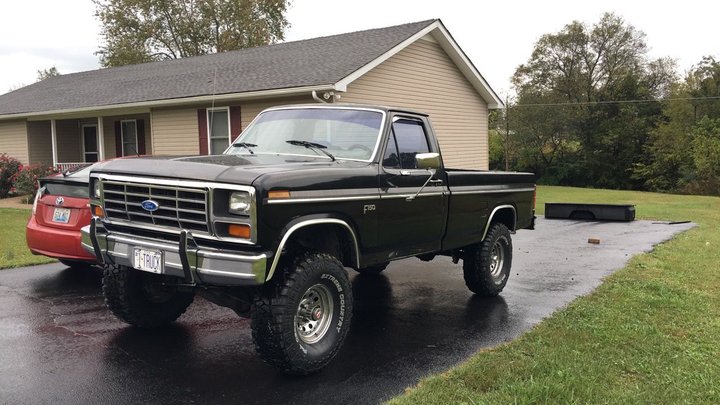

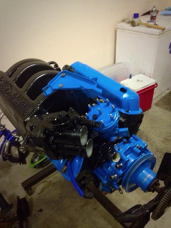

The is what the motor looked like when I put it in 3 years ago. Also a recent picture of my truck.

Full size f150 pickup with a little 302 engine and oversize tires. A classic combination for no get up and go. What gearing do you have in the rearends? A gear change would probably do you more good than anything. It will be difficult to modify the fuel injected 302 to add any appreciable power that will do you any good. A gear change with those large tires will give you a noticeable increase in the acceleration of your truck.
