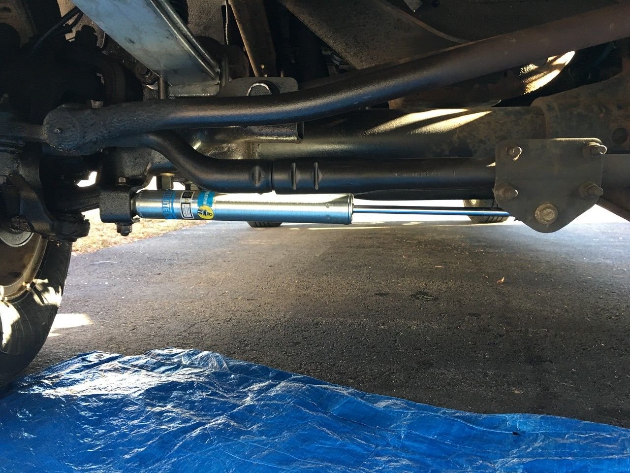

Thank you all. I went ahead and purchased Bilstiens and plan to put new ones in all the way around this weekend. Curious about the steering stabilizer as my 2005 4x4 6.0L does not have a steering stabilizer. My steering nice and sensitive. Why would some have them and some not?

You should ABSOLUTELY have a steering stabilizer on your '05 4x4. Is the hole there in the tie rod to mount it? Is the bracket there on the passenger side of the axle?

Here's a reference picture of where the steering stabilizer mounts.
