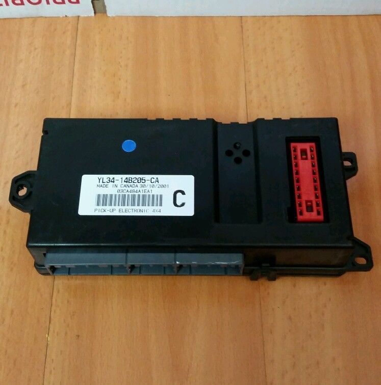

Here is a pic of a GEM for a 99-03 SD and X, or so claims the vendor. If it's the unit that has the keyless code written on it, I found it on our 04 SD. It's towards the center from the steering column, near the back of the stereo unit, and it's a real PITA to get to. At night you can read the numbers off it (I did) with a good source of light, but in daylight it would be very hard. Getting to it to replace it ... ouch, hurts the skin on my big hands just to think of doing that.
But we found (thanks to that linked thread) that on an earlier SD, it's attached to the under-dash fuse box. We'll check its connections.

The GEM is screwed to the back of the fuse box.
