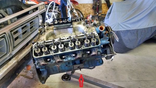

You only need to take off the nuts on the bottom of the engine mount studs, you will then be left with the studs to navigate out when you get pressure on your hoist... Then when the block is out you can replace the engine mounts on the block. See pic below, also mine had an aftermarket intake so im not much help, but word to the wise, make sure those threads in the intake are in decent shape, otherwise you may have a nasty surprise under-load, seeing yours are still cast iron your prolly alright... If your attached to an auto trans, dont forget the flex plate nuts....starter....
Mount with stud

This made me more nervous than any:

For pulling the engine: If you have OEM heads, there should be holes on the front and back sides that you can thread into and span the chain across the engine. You can see the holes on the heads in the picture above my post.

You for sure can use those holes just watch your valve covers if they're nice or they'll be dented. Using the heads is safer but I like the control from the intake.

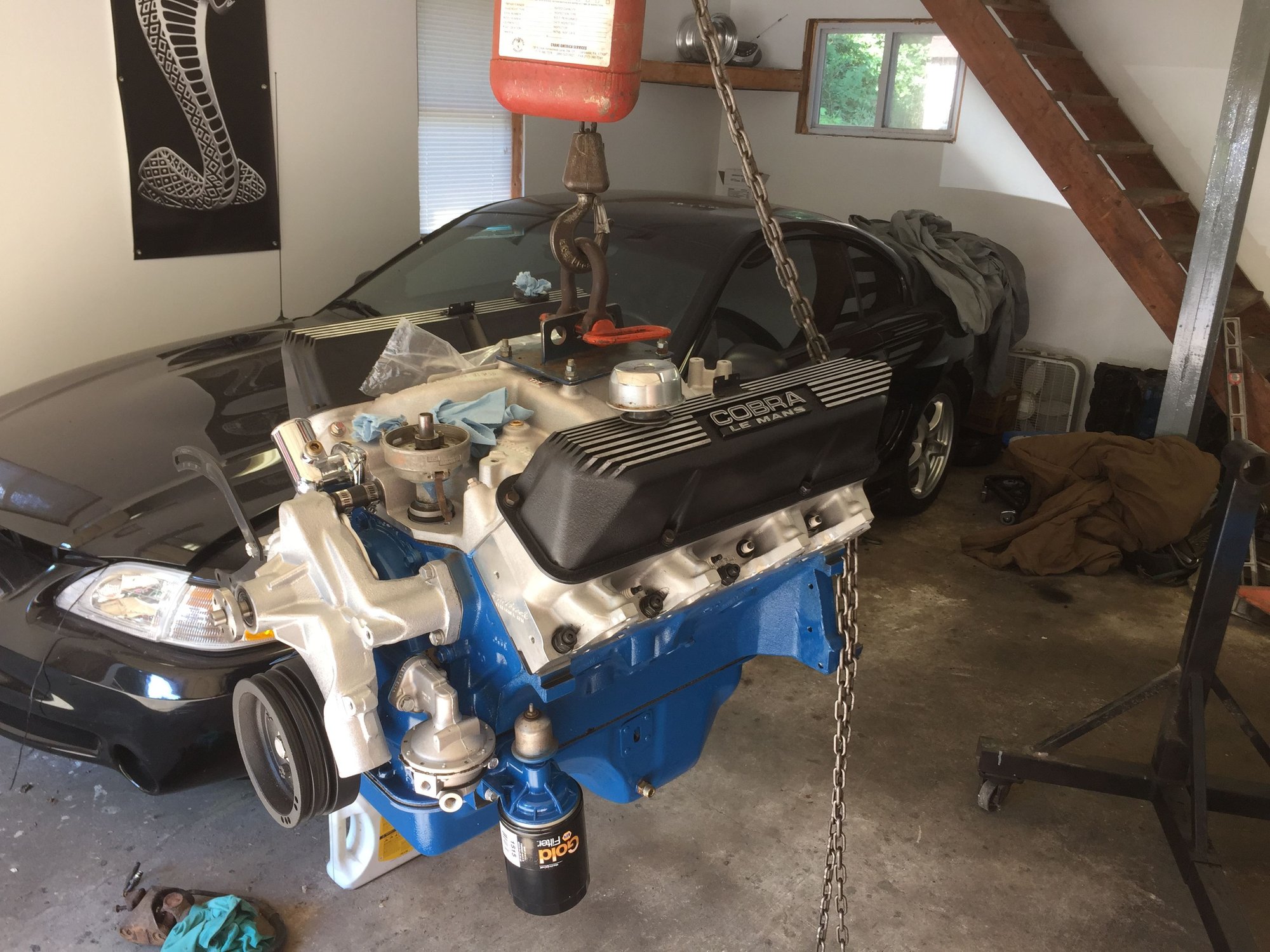

Stock manifold is cast iron. Plenty strong.
This little plate from Summit is rated for way more than the weight of an FE long block. The intake manifold is cast iron. I trusted it to hold and it did.
Cheers!
https://www.ford-trucks.com/forums/a...1&d=1517582510
Mount with stud
Thanks for the pic it's helpful. But I'm not getting any engine lift. It's just lifting the truck front end, I know it'll come up some as the weight comes off, but it seems hung up. This truck seems to have been worked on in town from Deliverance. There are threaded studs welded on the head for exhaust manifold and oversized bolts in drilled out holes for exhaust bolts, as well as gasket maker smeared over the outside of every mating surface. So I'm not sure that I'm not dealing with some rigged up deal. Which is the main reason I want to pull it, clean it up and replace all the gaskets. It's a 4 speed, but the steering column has been sorta replaced with one from an auto and the floor was cut to add for the shifter. I suspect it was originally a manual column shift and someone added the 4 on the floor and hacked a new steering column in. So anything is possible.
