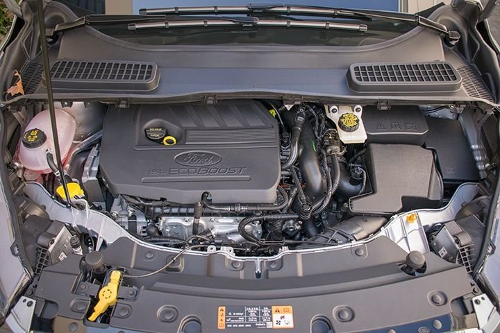

Hi all - is there a quick way to ID which engine is in the newer Escapes at a glance? I am finding some sellers do not know and/or confuse which engine is in their vehicle. Thanks!

1.5l ecoboost or 2.0 ecoboost

The pictures in the post above, are both the engine compartment views of a 2017 Ford Escape. The top picture is that of one equipped with the 2.0L Ecoboost engine. The bottom picture is that of one equipped with the 1.5L Ecoboost engine. Hope this helps.

Get/look at the VIN and look at the eighth character for the engine for whatever model year you're looking at.

Thanks! I am only interested in the 2.0L - funny how many people don't even know what engine they have in the vehicle they are trying to sell.. They just say "ecoboost"

There should also be a sticker (seen in pic 2) that says what size the engine is.
