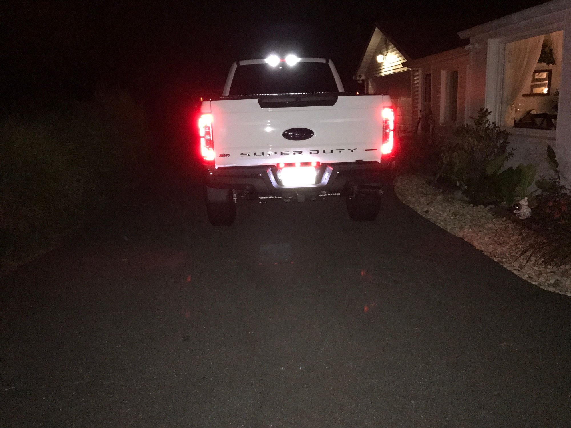

All Led's no resistors. every outside light is led. Front turn signals turn yellow to Blink ( Morimoto 7443 Switchback XB White/Amber LED)
Dealer turned off the Bulb out in the service lane in 5 min and Off iI went.

SYLVANIA ZEVO 3157 Red LED Bulb, Amazon
Amazon Amazon
I found these worked best for the rear brake lights very bright because of the way the chips are mounted on the angled plate.
