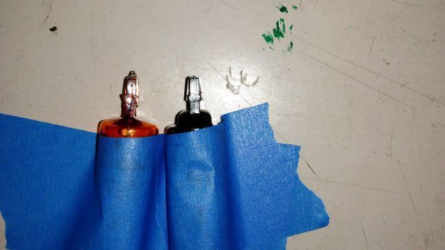

When replacing the front turn signals with LEDs, make sure the LED snaps into the socket securely BEFORE putting it back in the housing. I had to fish out two LEDs out of the housing, using a magnet. They popped out of the socket as soon as I put it back in the housing!
Looking at the picture above, note the length from the base of the bulb on the left, to the actual bulb itself. Then look at the LED on the right.
This is the problem I had with three different set of LEDs, before I determined the fix was to grind the plastic base of the LED so it goes into the socket, far enough to lock in. I've had them in now for about 9 months without issue.
I seen you mention this before. Great tip and I intend on comparing the new ones to the old when they get here to see if grinding is needed. Thank you!
