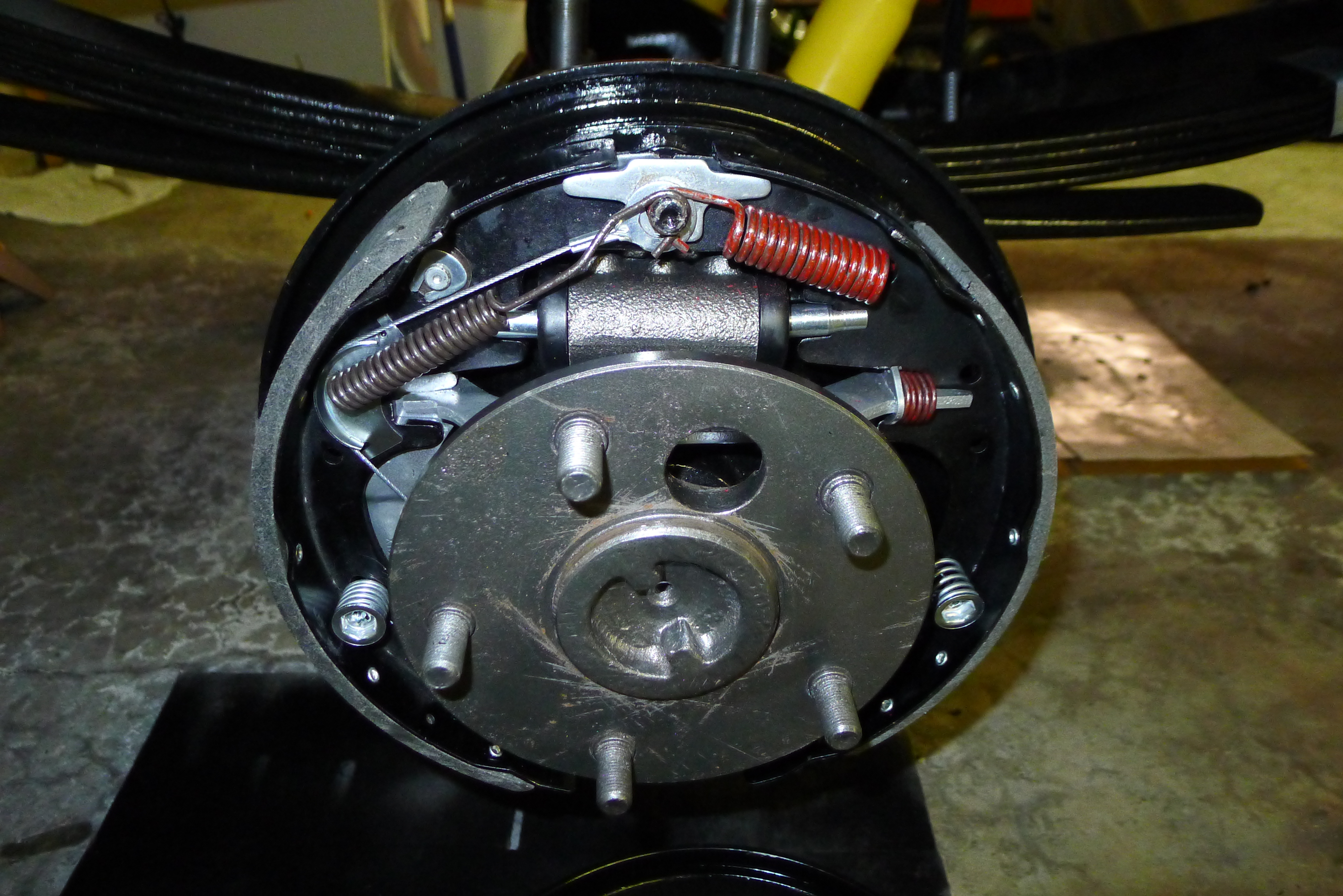

Looked at Rockauto site. pics show a long and short shoe.
http://www.rockauto.com/en/catalog/f...rake+shoe,1688
Old Jan 26, 2018 | 02:32 PM
Tedster9's Avatar
Tedster9
Joined: Apr 2002
Posts: 19,311
Likes: 97
From: Waterloo, Iowa
Seems like most of the brake shoe suppliers don't offer a primary/secondary for rear brakes anymore. Instead of being grabby I would think they would be less effective?
For whatever reason the manual says that the crimp on the adjuster cable, the eye part where it attaches to the anchor pin, shall face inboard. Not sure what difference that makes but they did go to the trouble of mentioning that.

Originally Posted by mrpotatohead
Looks perfect except the shoes appear to be the same length. There should be a primary shoe which is shorter on the front or left side in this picture.
Fixed! Moral of the story, buy your shoes at NAPA not AutoZone or O'reillys. Both places looked at me like I was crazy when I asked to see more and since they were all the same asked to return the ones I had bought.
Tedster9 - If the manual says so, I shall do it, also fixed.

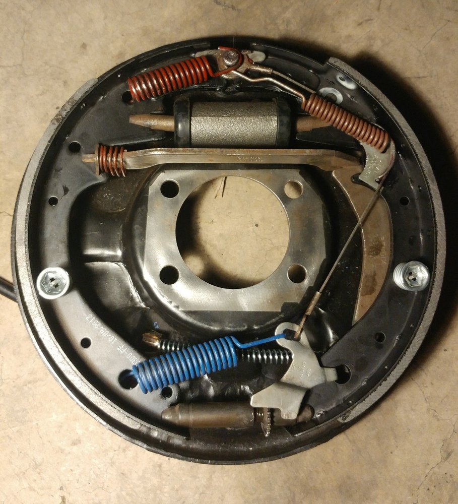

Got mine at NAPA and they had 2 short and 2 long shoes
https://www.ford-trucks.com/forums/a...1&d=1497160661
