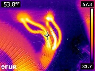

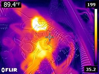

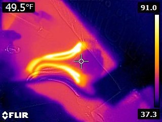

I did a little trouble-shooting today.
My GPR was buzzing.... loose contact on the hot side. I took some pics with an infrared thermographer I have through work... just for ****s. You can see the GPR terminal glowing at 199F (these are all surface temps).... that is too hot and indicates it was likely arcing and causing the buzz.
I shot the wires at the harness as well. This is all just with the key on, engine not running. Even with the buzz I was still getting juice to the glow-plugs which makes me think they are likely fine. Am I correct? Or would these still flow current even if they were bad?
I had a new Alliant GPR in the garage and swapped it out, tightened the terminals and will re-test it tomorrow once it cool off again. The buzz is gone.

As far as the IR photo shots on your glowplug system is concerned, yes you glow plugs are working. In one photo the wires are 50 something degrees and the other nearly 90, I would guess the cooler wires were the first photo taken and probably the same temp as the others when it was taken. The photo of the relay is hard to tell what is what but if you changed it out and now it doesn’t buzz you should be good there also.
