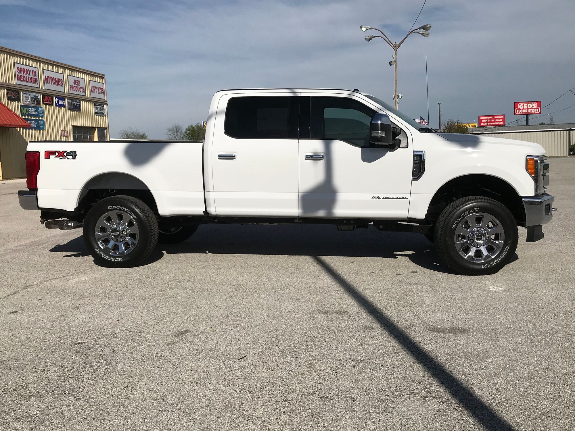

2 inch bds level with fox shocks.
Wheels and tires are on order.

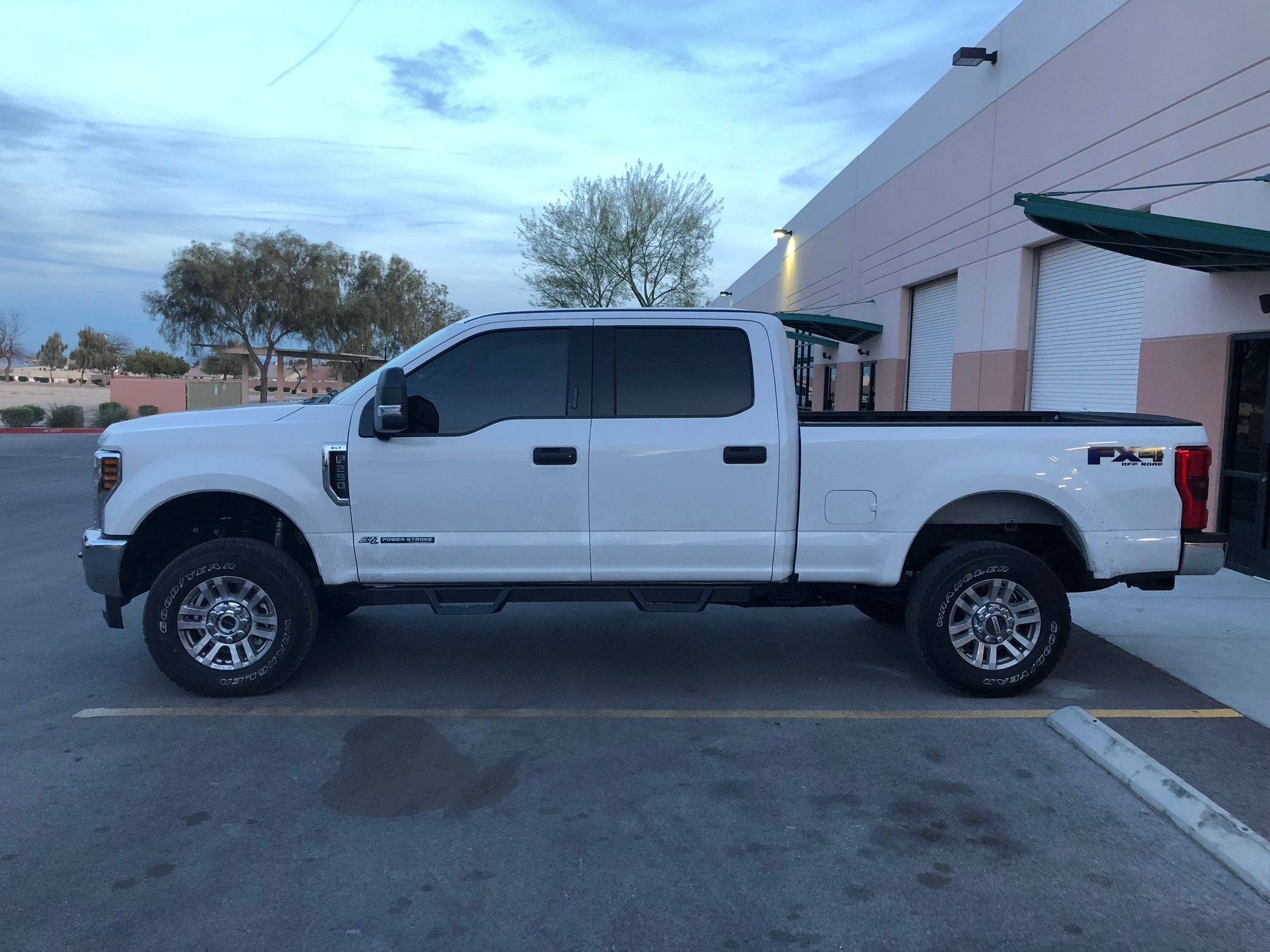

2” BDS with BDS nitro NX2 shocks.
Not sure you can go wrong with either. The front end is much smoother now.
