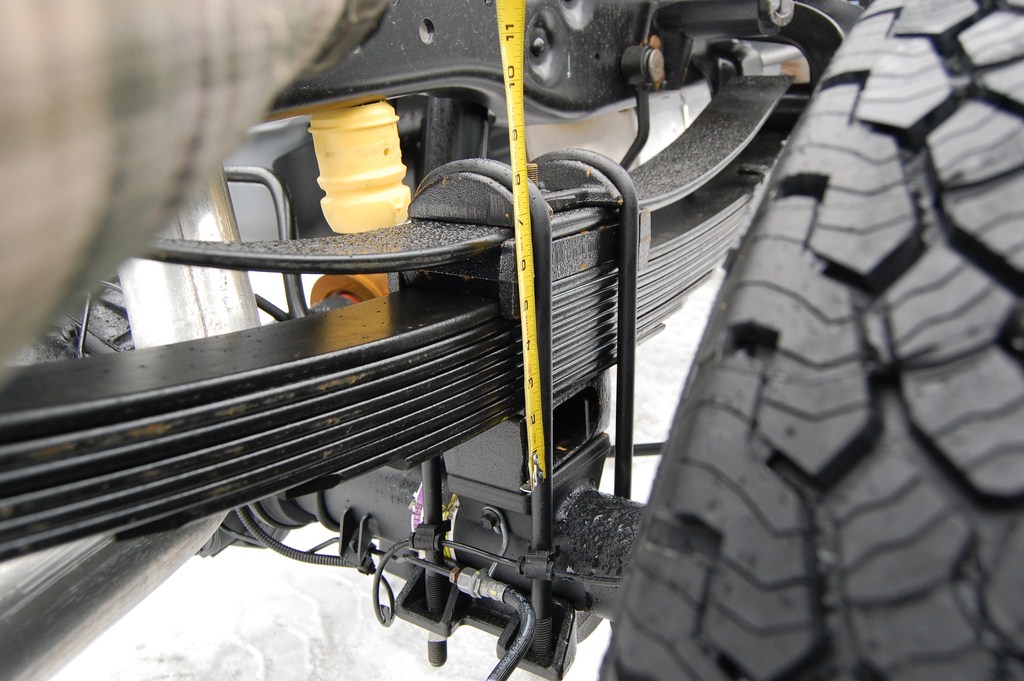

I also considered buying a spring pack off a F-350 SRW bed delete which has more spring leafs but then I would need to source a bigger U-bolt from somewhere.
It's just a decision whether I want to try and hack together a "kit" from OEM Ford parts from the class 4 or class 5 trucks or just buy a commercially available kit. It's just the thought of the spacer being a non-springing chunk of metal. I guess I can also get custom springs made up but I don't want to spend all that much (if I did I would just do a full suspension swap kit and be done with it).
