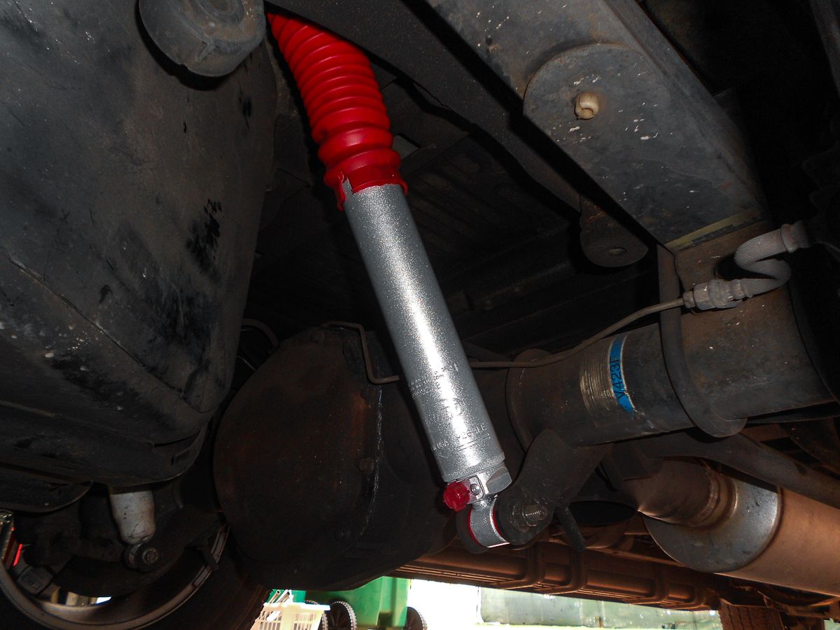

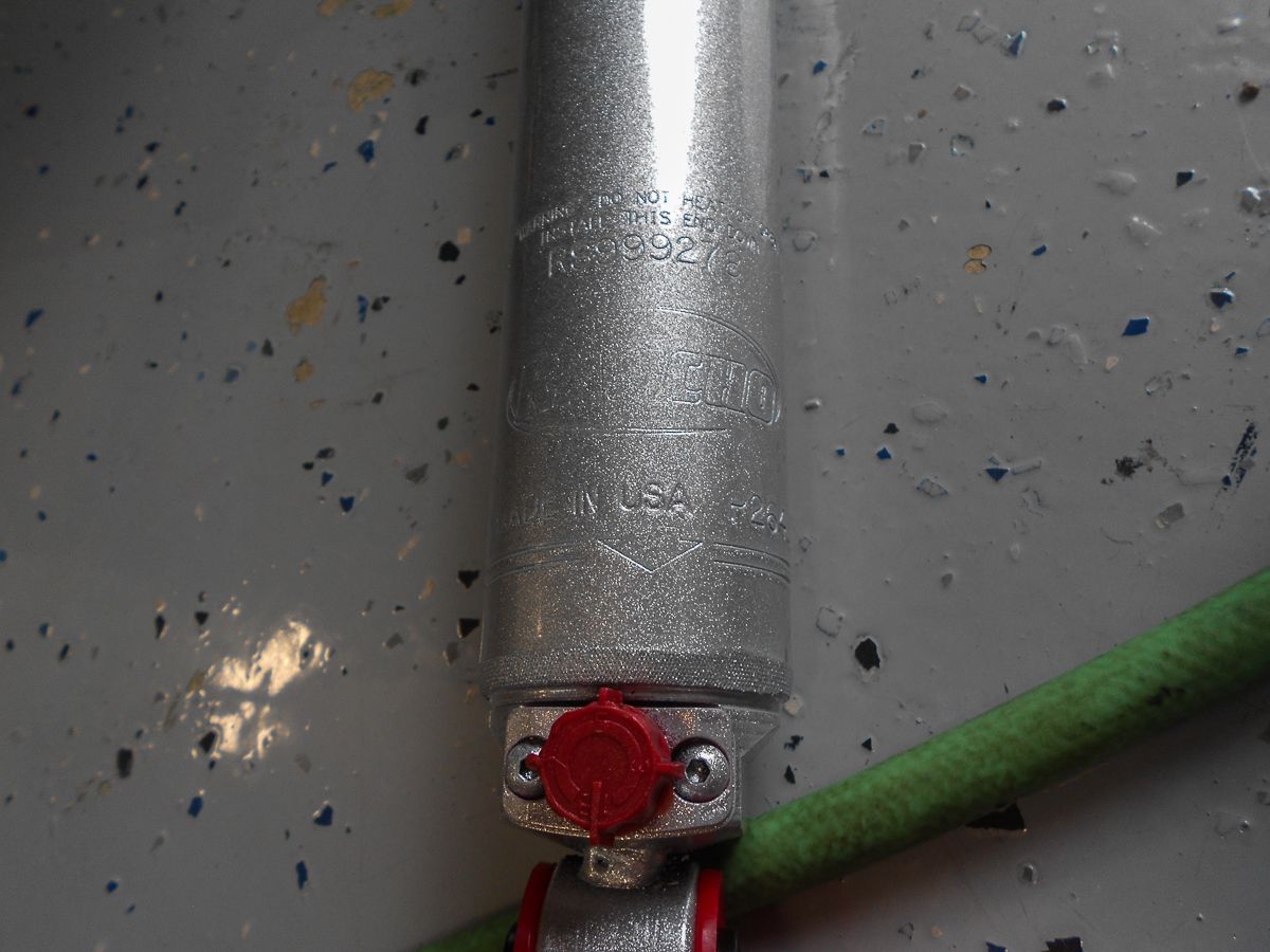

First to be tackled.... shocks. The shocks on the truck are done. They were some old Pro Comp ES3000's that basically let the truck rock back and forth for 10 seconds at every stop light. They had to go.

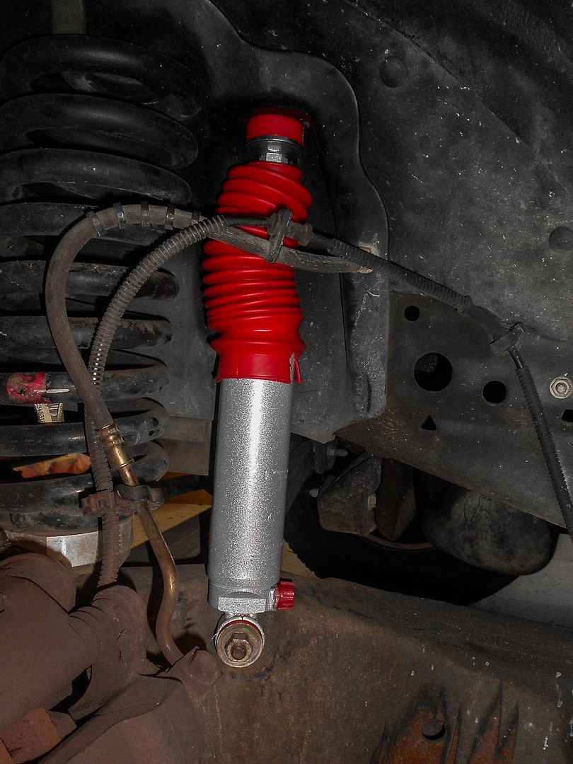

I went with a set of Rancho RS9000XL's. Not going into huge detail as there have been various write ups on shock changes for these trucks. I will say... passenger side is a pain in the _____.
Here are the new Rancho's in place. I set them all to the "mid-setting" and I will drive a bit to get them moving. I'll then go a bit stiffer and see what settings I prefer.
love the fact that the shock mount bushings are all poly. The is huge and should definately last the life of the shocks. The rubber that was on the Pro Comps was done. Shocks did not even need to be leveraged off. They almost dropped off the studs up front.
Made certain to mount adjusters so they are all accessible.
Overall after installed the difference in the ride and drive are monumental. No doubt given the shocks I pulled off could be extended and contracted with two fingers on the seats.

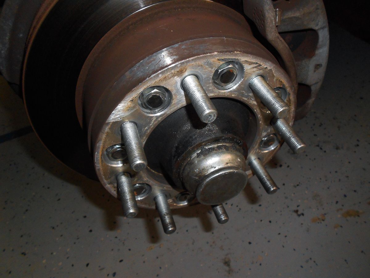

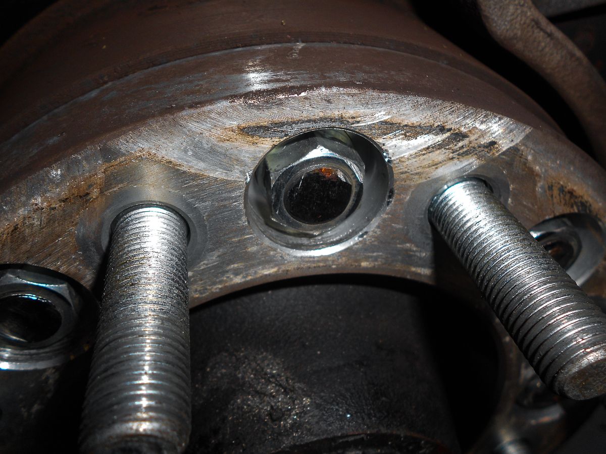

Some Neanderthal thought this was a good idea to put some later model wheels and tires on the excursion and took it to Bubba for the work.
They dropped in a 1" spacer but to do that they had no choice but to cut the original studs.
After some searching for new studs, I've decided to take the opportunity and replace all four wheel hubs. I'll get the new studs and get brand new bearings and races in the process. Kills me that I'll have to sink unexpected cash here though.

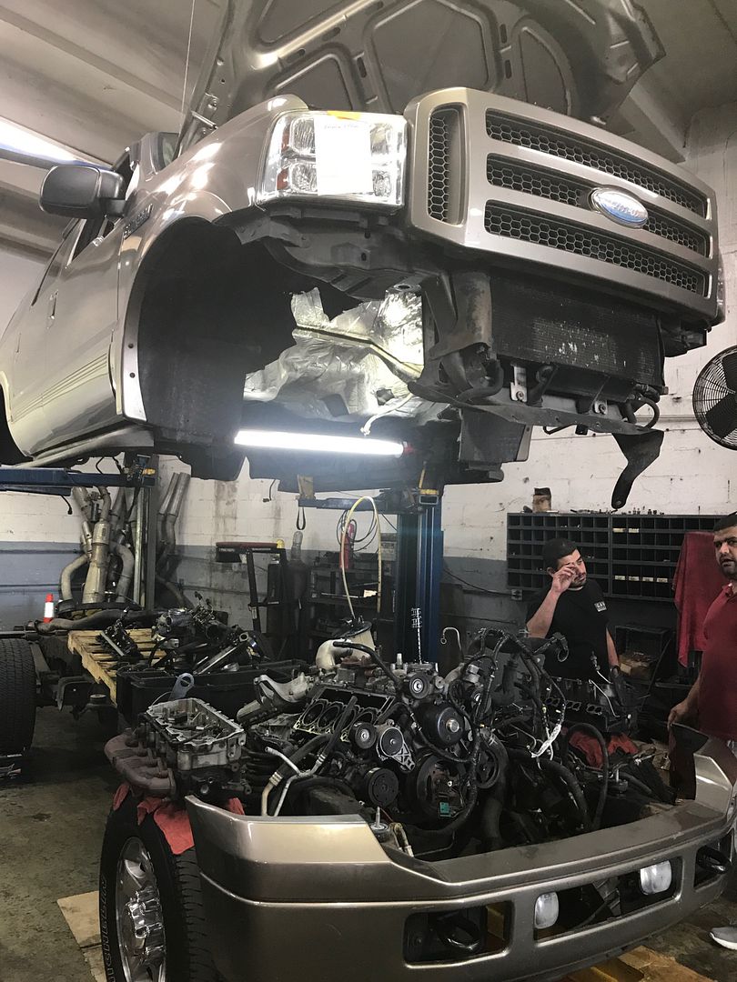

So yesterday we dropped off the truck at a well known diesel specialist in Miami. Don't know if we are allowed to mention vendors... if so, let me know and I'll post it. Have not looked in the "rules" section recently.
Regardless, the truck is at a shop getting some work done. Specifically, ARP Headbolts, new head gaskets, Ford oil cooler, EGR delete, 3.5" down pipe, new exhaust going back behind passenger real wheel again and, new body mount poly bushings. Here are some shots the shop sent me...
Weight reduction :-) to allow access to the body bolts.
The body and heads off. Engine is looking real good and very well maintained. Now it's just going to be even better....

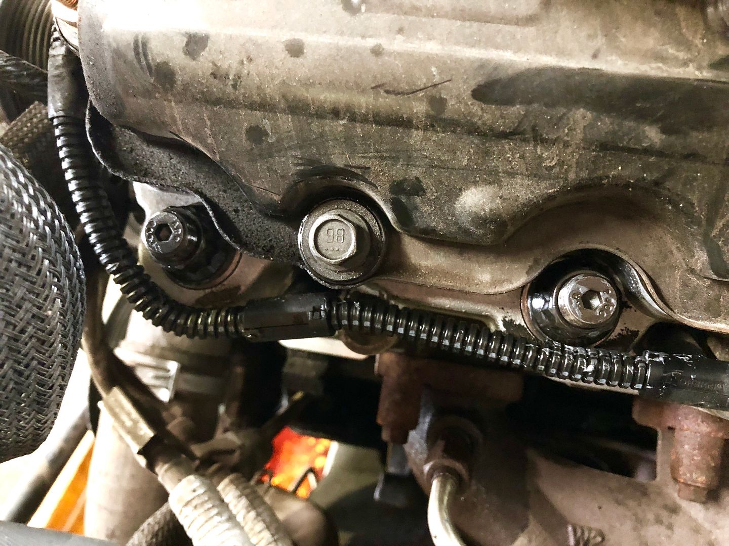

Shot by real quick to get a look at the truck and the guys were getting the heads back on. I took a shot while there...
While I was there, I got a real clear look at the lower portion of the block. Looking at the oil pan and upper oil pan I see there is some residual oil around there. I know it's normal to a certain extent but since we have the body off the truck doing the oil pan is far easier. Going one step further, since we are going to pull the engine to do the pan we are going to do the front and rear crank seals and the related cover seals as well. There is nothing at all around the bed plate to block union so that will stay untouched.
Bottom line... we just decided to do oil pan seals and the front and rear engine seals. It'll set me back a bit of time.... but going to do it all one shot with the body off.

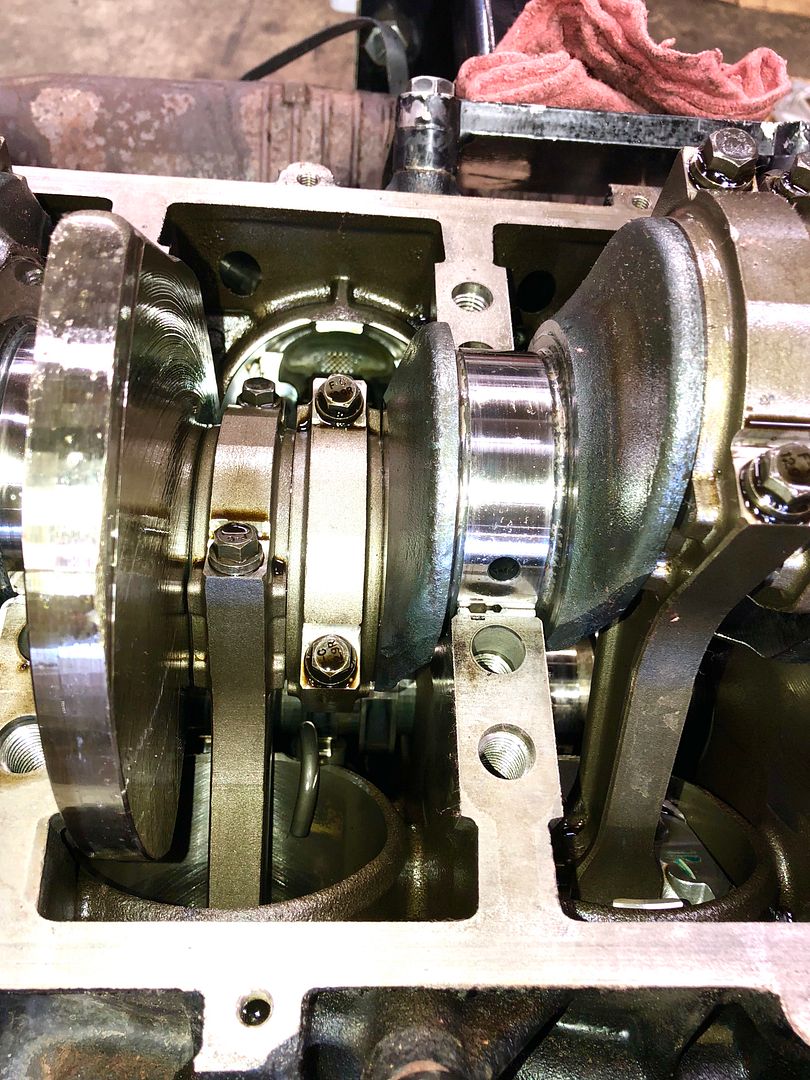

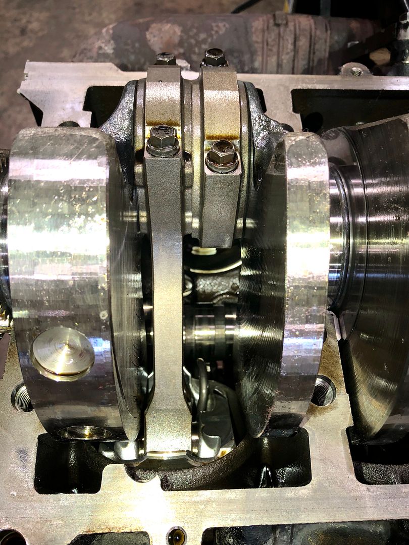

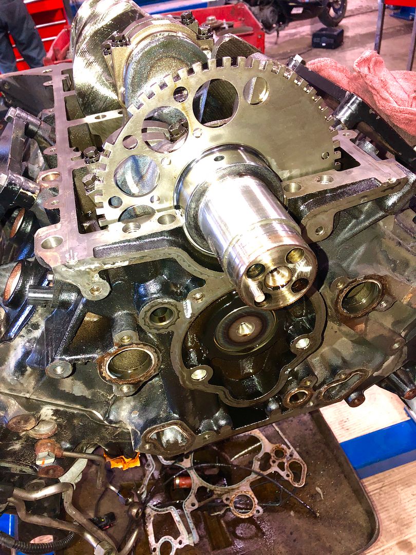

Anyway.... contrary to what I mentioned yesterday... we did decide to pull the Bed Plate. At the end of the day.... 99% there. Might as well. There was nothing showing as an issue, but why risk it.
So today, the engine came out and was dismantled. The various covers and plates removed along with the respective seals and gaskets. Everything was well cleaned and will be coming back together between today and tomorrow.
Here are the nude engine photos....
Front and back sides on the engine and the exposed crank with the oil pan, upper pan and bed plate out...
Crank journals and bearings look pristine. Pistons, wrist pins and rods look great. Cam and crank gears look great as well. Honestly nothing showing any overheating damage or fatigue. Overall, continues to look awesome.

Here are a few closer shots on the crank and some of the pistons and rods.

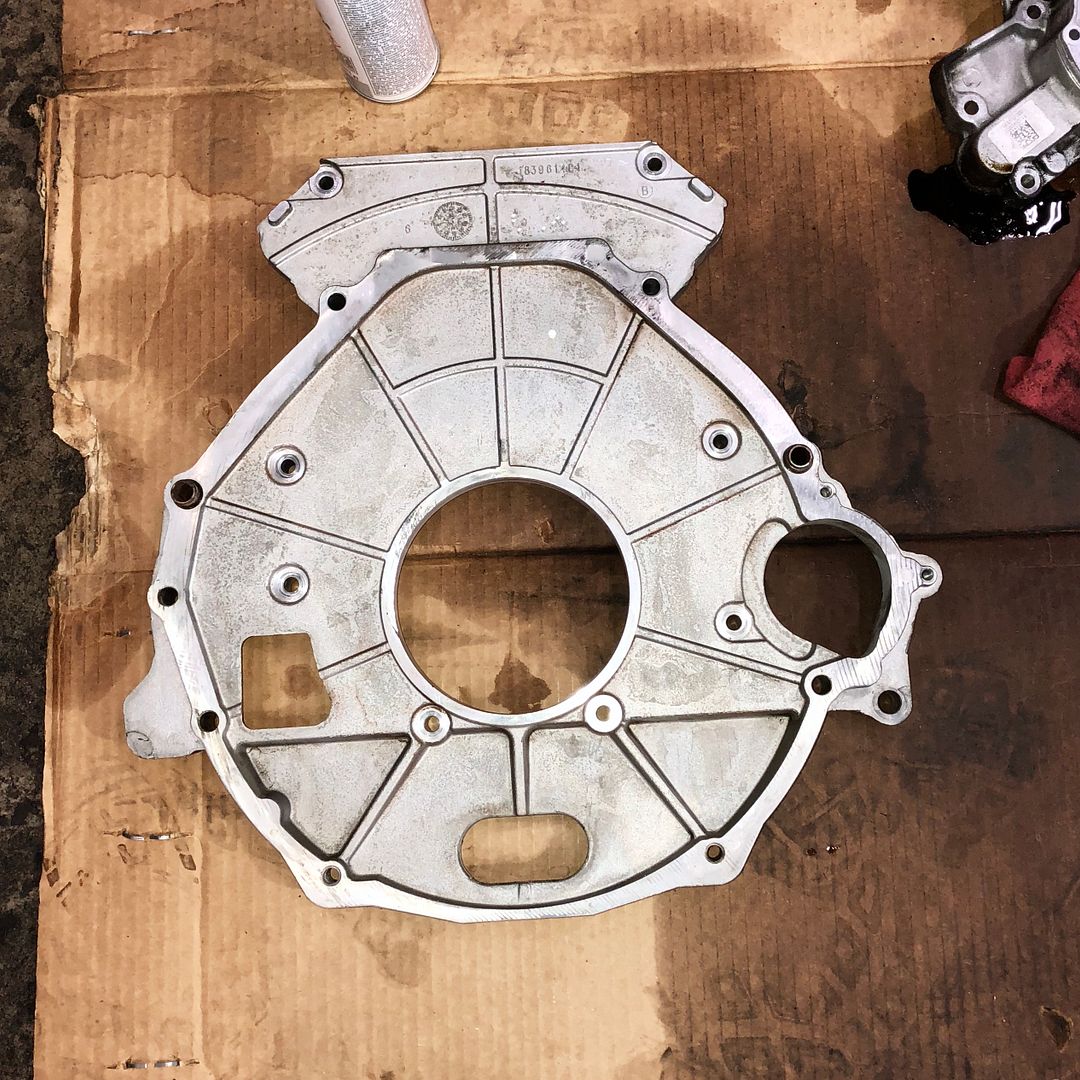

Below are the rear and front covers. In these shots, all cleaned up already.

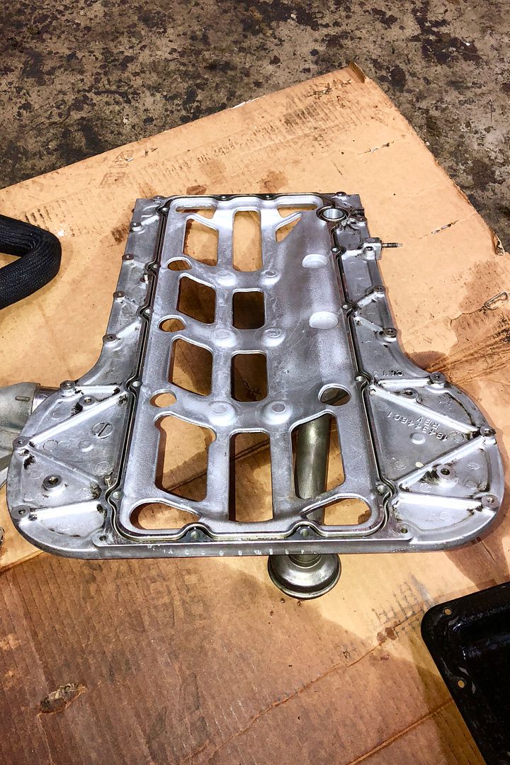

this is the top side of the upper oil pan tray. This was what was covered in residual oil. Now, cleaned up. The upper seal here seems to have been the culprit of the very light leak. The seal seemed to be a bit flattened when it came out.

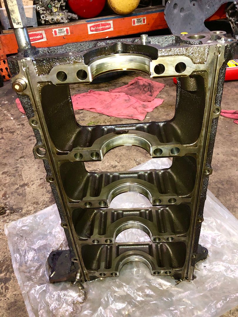

This is the bed plate. Here it is still grimy but will be cleaned up as well.
This shot was taken by the shop for me with the lower part of the engine re-assembled. Bed plate is clean with upper and lower pan in, all new seals.
