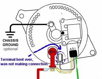

Solved. Pulled out a digital multi-meter with the truck engine running. (DMM probes go easily into socket.) Found a solid -0.01 VDC where 6 VDC should have normally been found with alternator in good condition. This condition led to ground leg of Indicator Bulb being pulled down from a normal condition 12 VDC to 1.6 VDC, lighting Bulb. The truck Volt Meter is apparently only indirectly controlled by voltage, there is a solid state module which actually controls the needle position. Will run it for another 2-3 weeks till I scare up some cash for a new alt.
Update Jan21st - Pulled old alternator. Found the 'S" single connector pin had been bent over by previous owner, as shown in 2nd image, apparently when he was dinking around with something. This "S" connector was NOT making an electrical connection. Am 90% sure if I would have been able to spot that bent pin all would have been OK. But as it is, I already purchased a new 130 amp alternator from eBay for 80 bucks, had it sitting right there; installed the new alternator and charge light has gone out and alternator is charging properly once again.
