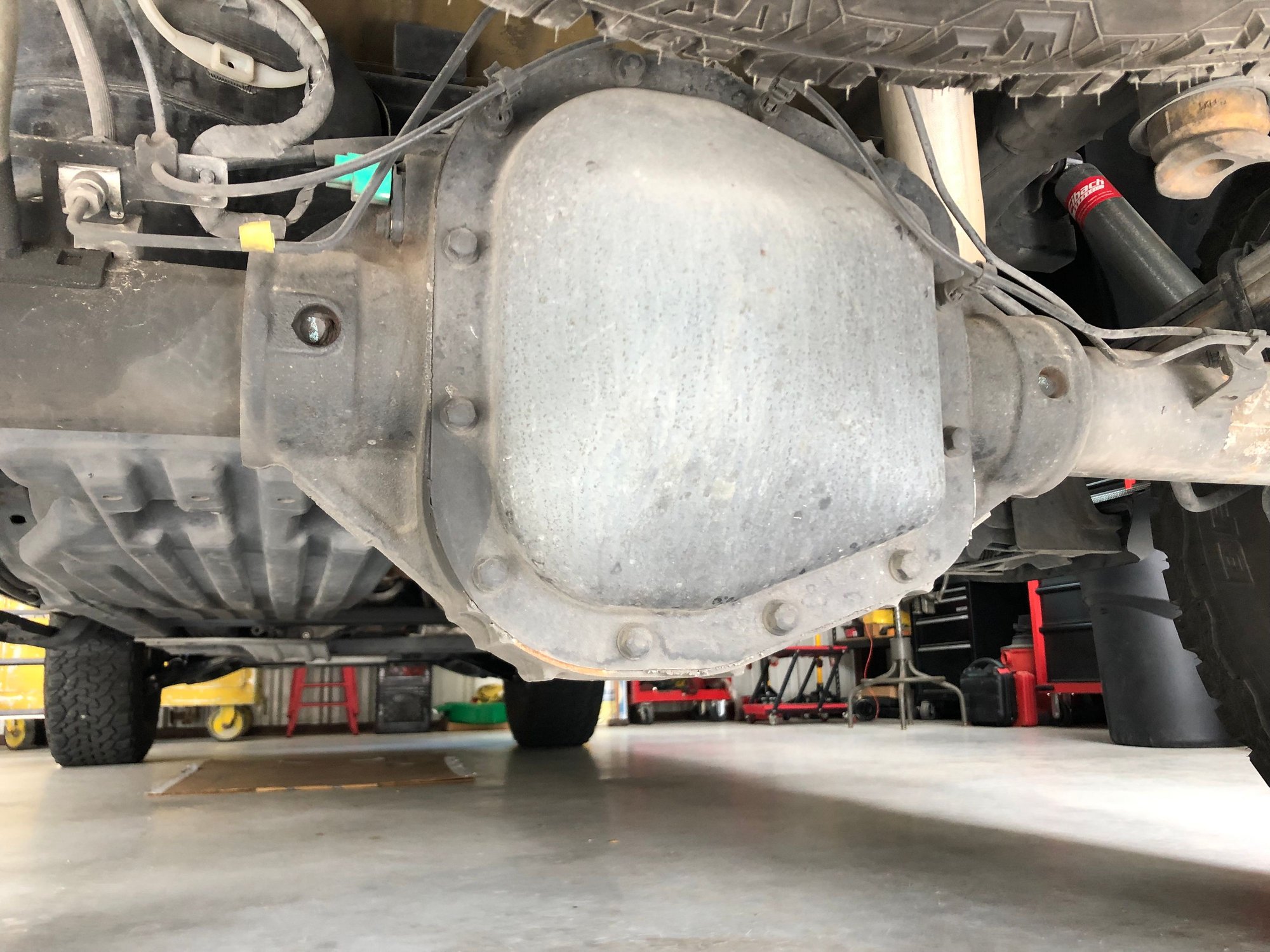

The 9.75 has 12 bolts and a more asymmetric shape. The 8.8 has 12 bolts and a more symmetric shape.
My 9.75
This is the super 8.8

[QUOTE=JKBrad;20779874]The 9.75 has 12 bolts and a more asymmetric shape. The 8.8 has 12 bolts and a more symmetric shape.
My 9.75
yes, my 21' xl has the same, larger axle, I had a photo of the axle tag as well, I will have to crawl under again to get another photo, I was suprised to see that it was the 9.75
my 2021 stx 3.55 has the smaller axle, i am looking for photos i had posted on a different thread, both have the 2.7eb engine.
what is strange is the 4x4 stx gets over 24 hwy, the xl gets 20mpg.
Thanks
