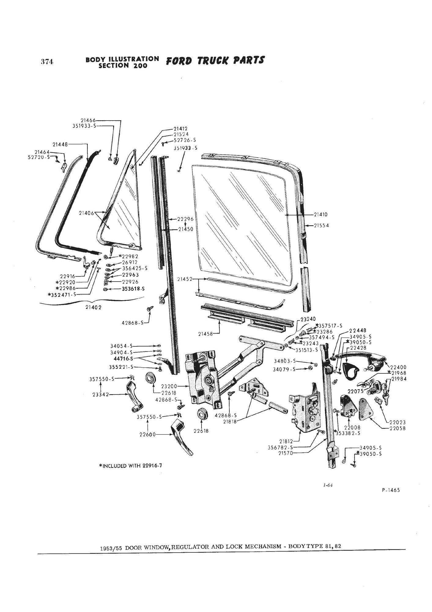

The thickness of the glass isn’t the problem. As Abe said, there is a lift channel (see below) attached to the bottom of the glass. It is too thick to fit through the slot in the top of the door body. Especially with the lower felts in place.

The glass alone will slide on because it does slide up and down when you open and close the window.
But as I said in post #6 above, there is a metal channel that the glass is I served in. The rollers of the window regulator engage in this to put the window up and down. This will not fit in the narrow window opening.
These examples are 53 to 55 windows but you should get the idea.
