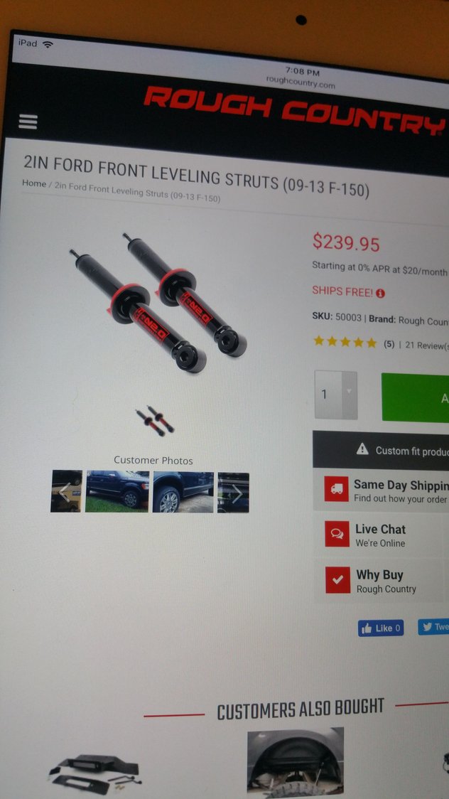

This is probably what you have its a longer strut that gives the lift so essentially it is a level and you wouldn't want to put another on top of that ...you could ...but you don't want to

Yeah so it’s a Rough Country 2” leveling strut. Saw the markings on the side. So question is now, can I clear 35s as is or do I need to try and put a 1” spacer and UCAs on it......

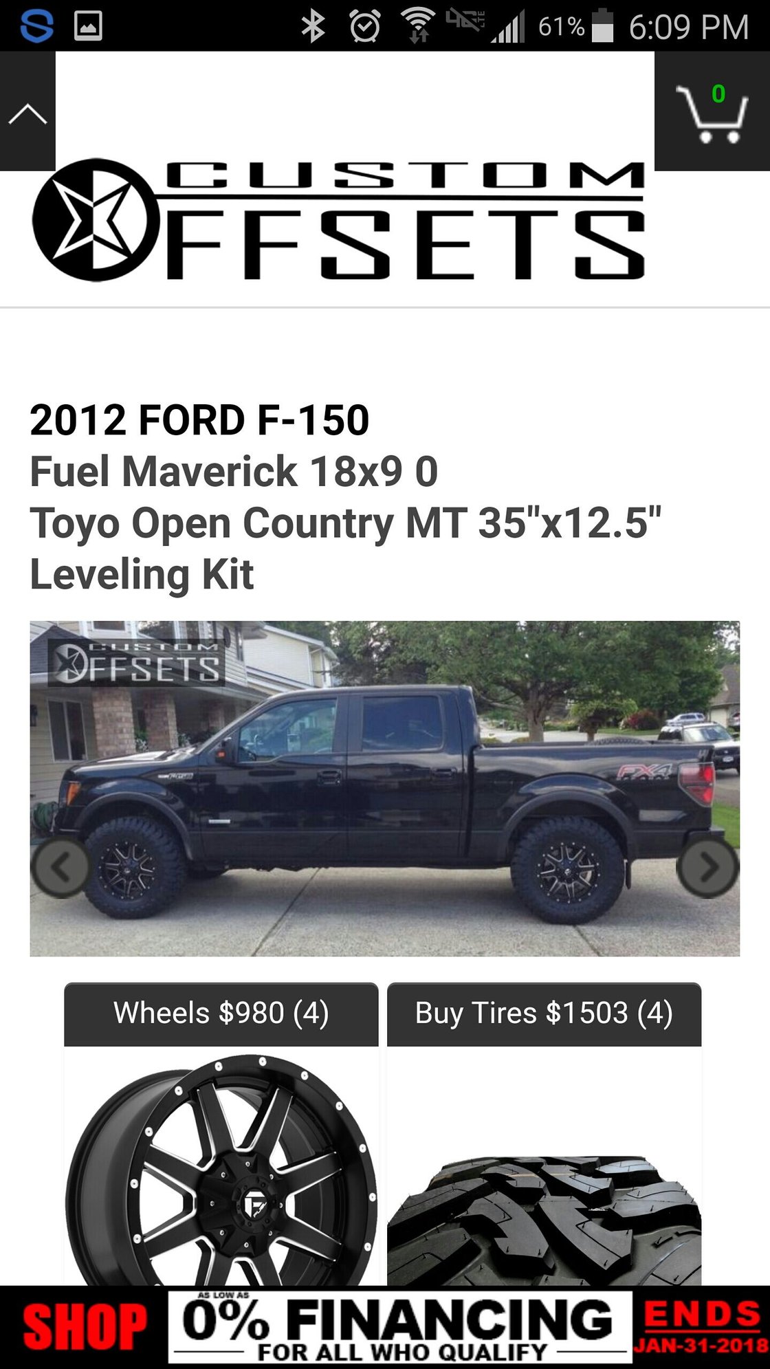

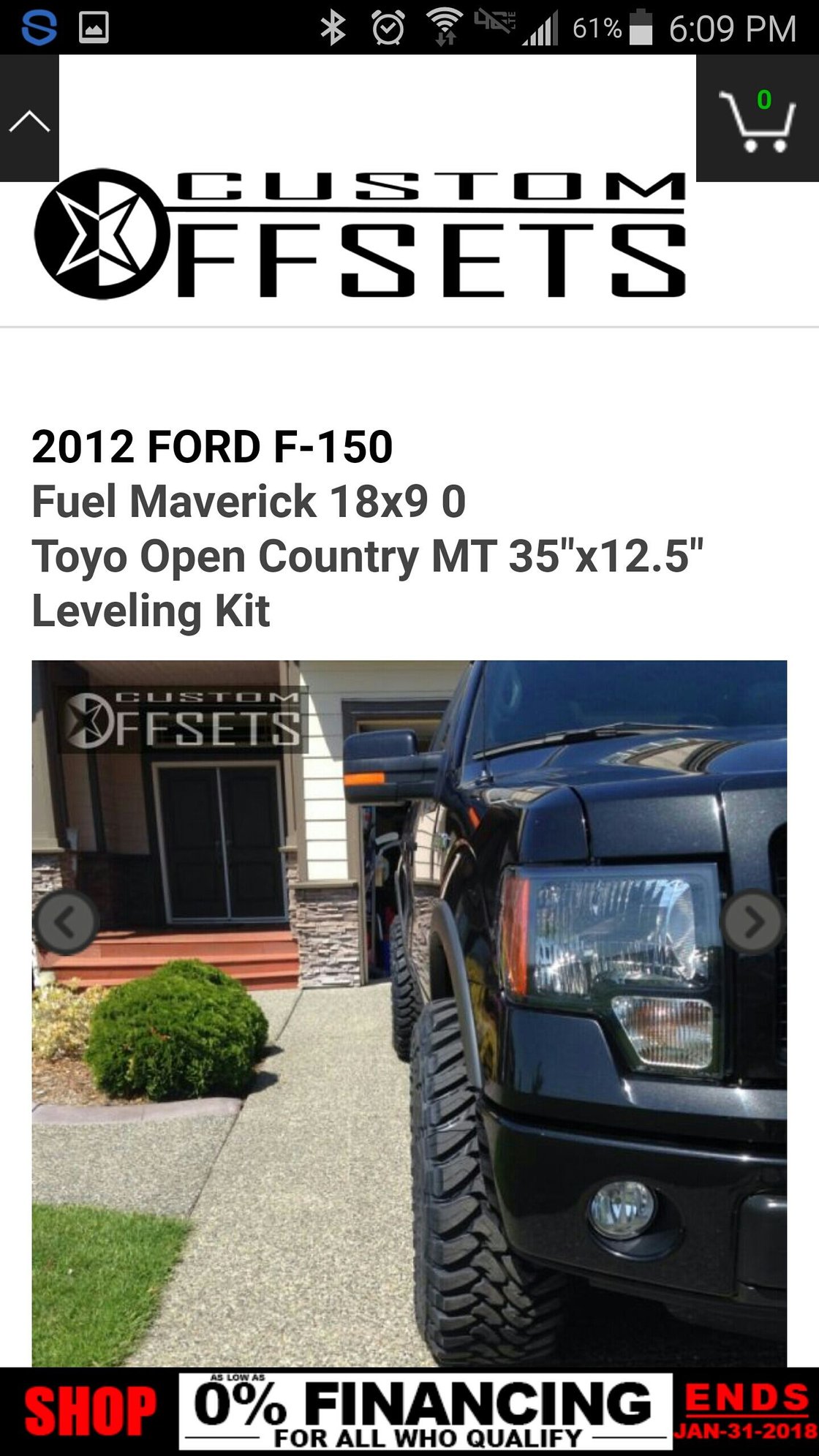

I recommend checking out Custom Offsets website they'll have tons of pics and info like below
Old Jan 4, 2018 | 07:22 PM
CuNmUdF250's Avatar
CuNmUdF250
Joined: Nov 2010
Posts: 2,043
Oops didn't notice the finance info just screen shotted and posted definitely not intended as an advertisement and I have no affiliation with that company.
