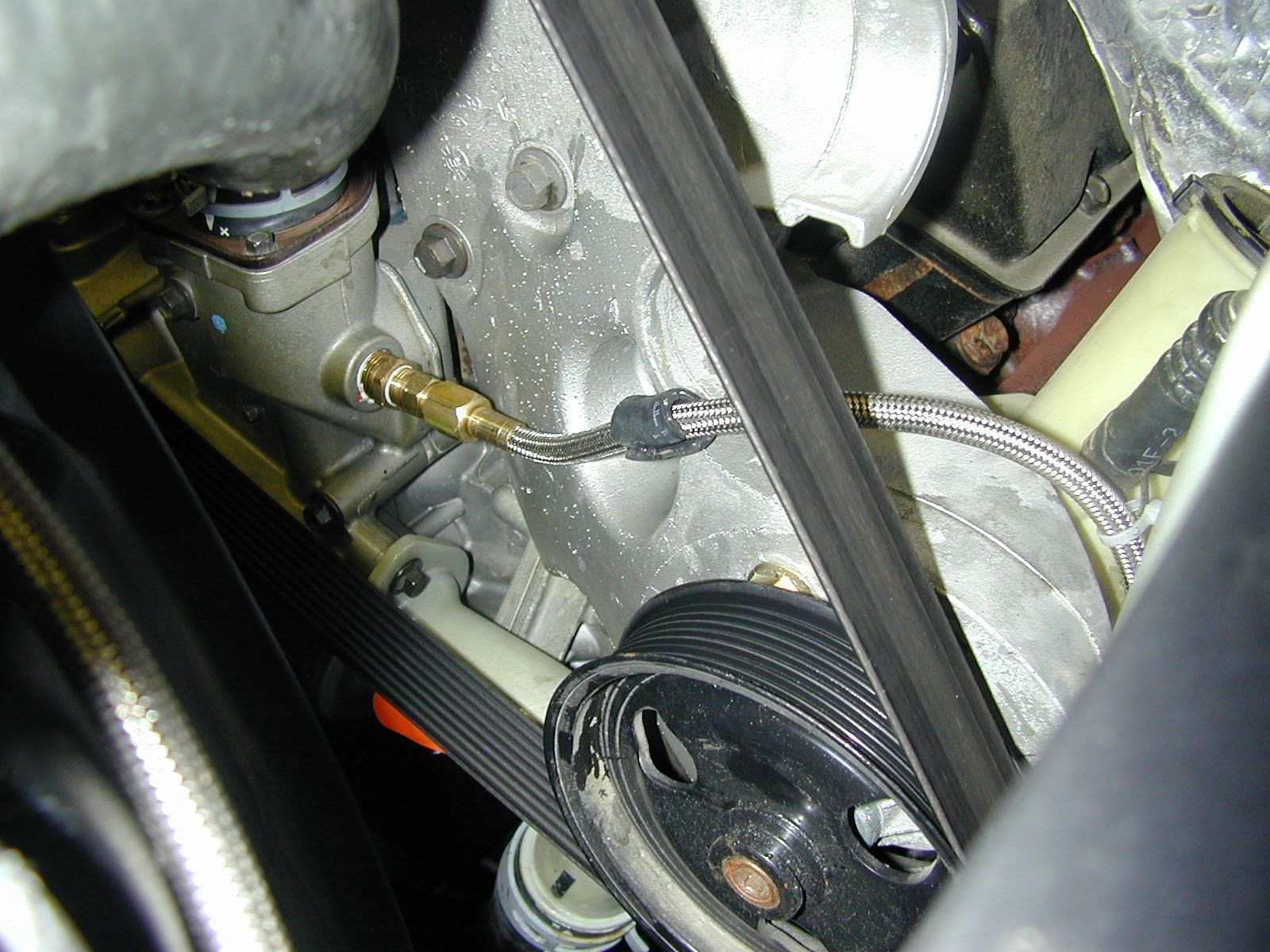

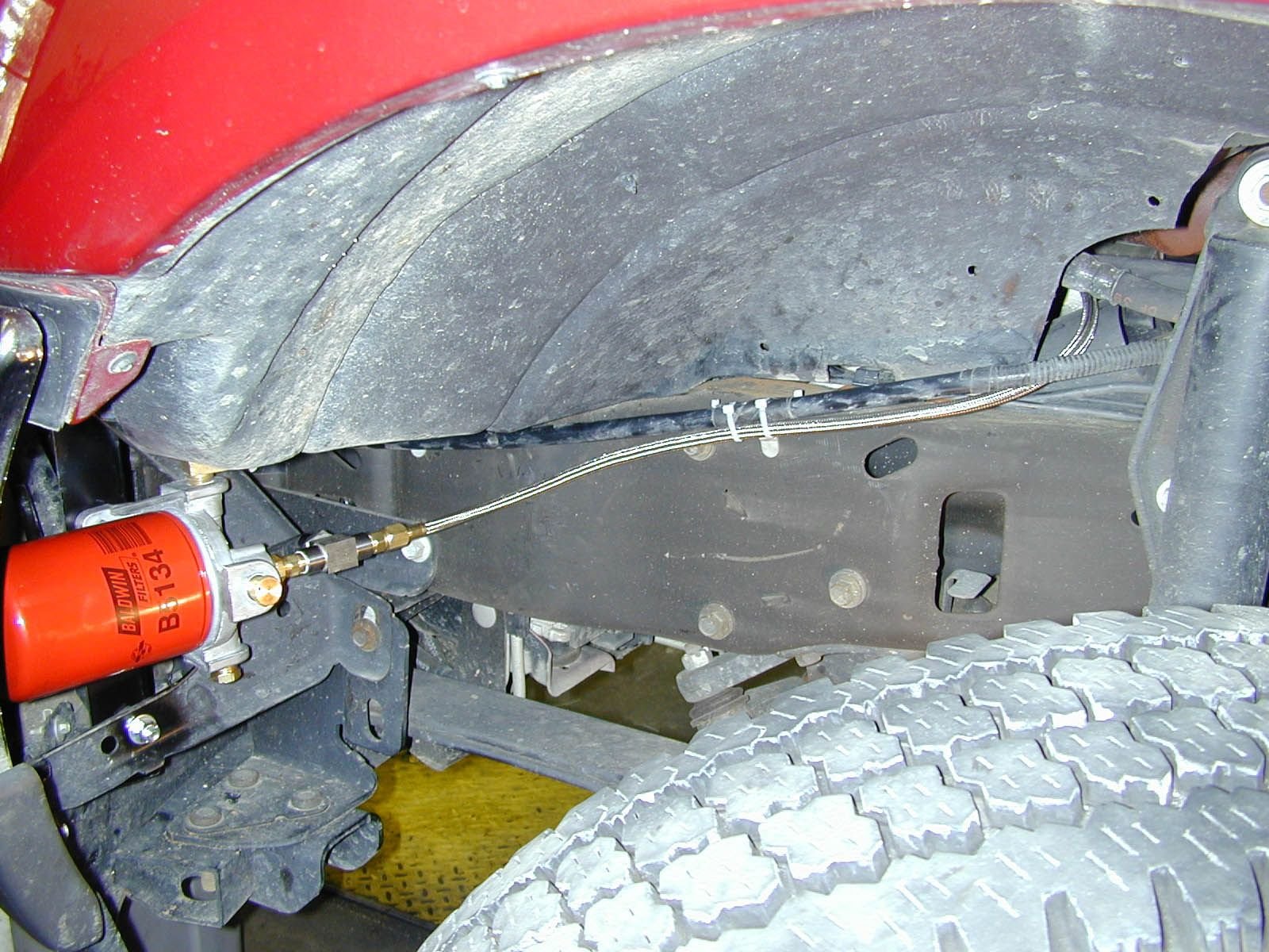

3rd: Back 10 or 12 years ago a Member here (think he is long gone) named Beachbumcook put a DieselSite bypass coolant filter on and documented the results in a thread here. Unfortunately the pics from that thread are gone, but here is a link to dieselsite's coolant filter and the pictures of the casting sand captured are Jeff's. Back then it was an eye opener...
http://www.dieselsite.com/2003-20076...waterpump.aspx
So, while your point about not being able to capture Large particles with a bypass filter is true -- There are a number of folks that have removed finer particles, which are also harmful to the system and could clog a cooler, wear a pump impeller, etc., and have posted pictures of the crap caught in those filters.
They do work.

Mark,
I was going to do the same plumbing as you did, which is why I had them tabbed in eBay, and asked IPR which of the two manifolds which they have pictures of they were now shipping. I contemplated doing the backflush as you state too. But the particles I just found in my recent cooler, and how embedded they are in the passages where I don’t think back flushing will clear, has me changing my mind.
Again we both have opinions, either or both right, and I think whatever anyone wants to do is better then stock.
IPR sells the entire setup for $250, I think it can be done for around $100, but just not 100% that I can bring those ports out to 3/4”. If not, more hunting will be needed. Maybe a Moroso or Hamberger adaptor.
