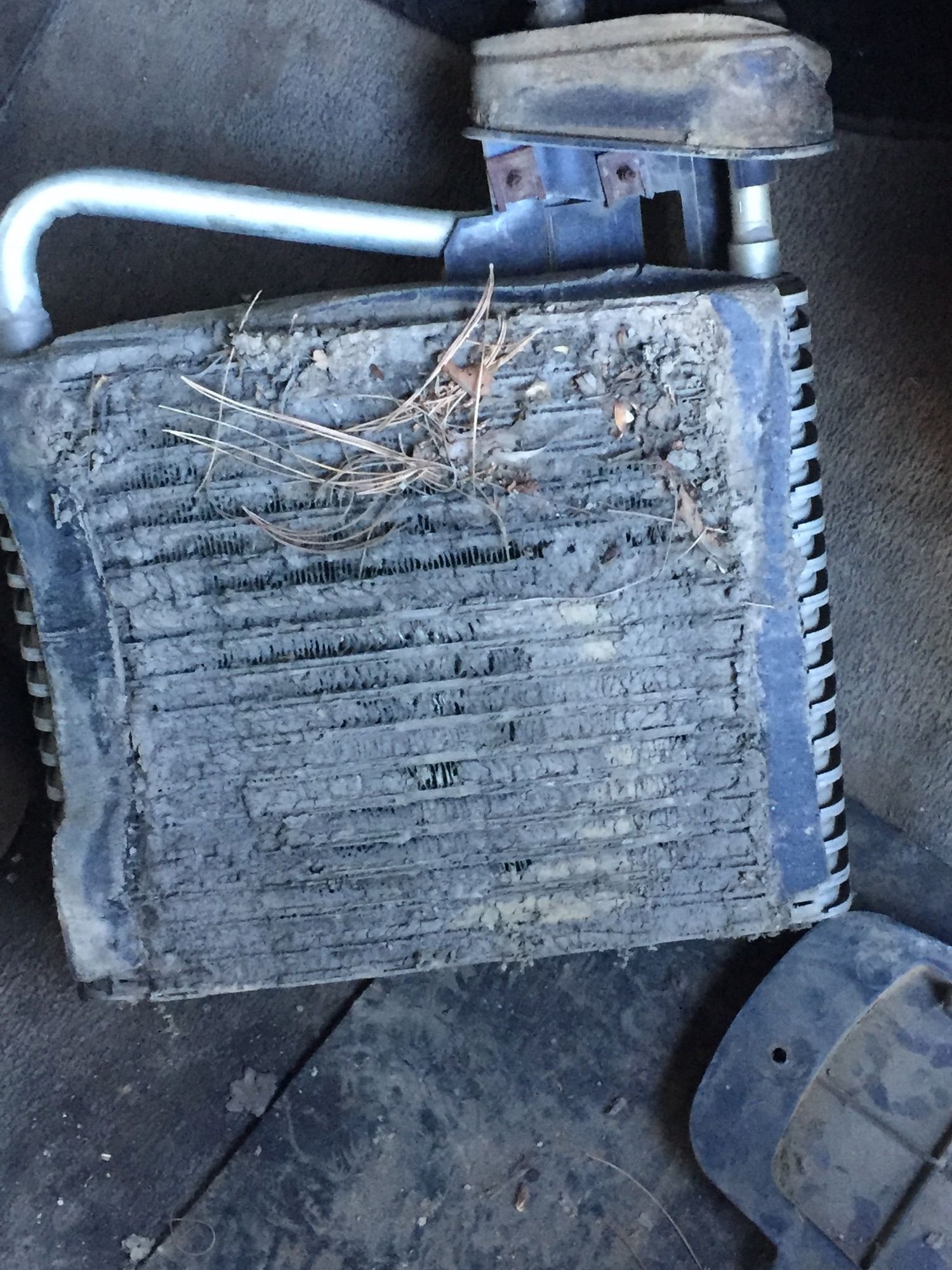

Think I found reason of air flow also
Old Jan 17, 2018 | 04:03 PM
Destroked 450's Avatar
Destroked 450
Joined: Dec 2015
Posts: 2,543
Likes: 322
From: Harned, Ky
That could cause a bit of a issue
Are you going to replace it since you have the old one out.
Old Jan 17, 2018 | 05:20 PM
proline69's Avatar
proline69
Joined: Apr 2010
Posts: 59
No that’s the AC evaporater , the blower vents right threw it then reaches the heater core . I eliminated it for the mean time , since going out tonight to relocate snow . Now I have lots of warm air coming out the heater vents . I took it home and ran it un water then took a toothbrush to remove the rest of mud . I guess that’s why I hardy had cold ac in the summer . I think the previous owner had the truck in a quarry, since I’ve always removed caked on mud from all over , in and under the cab and actually entire truck
