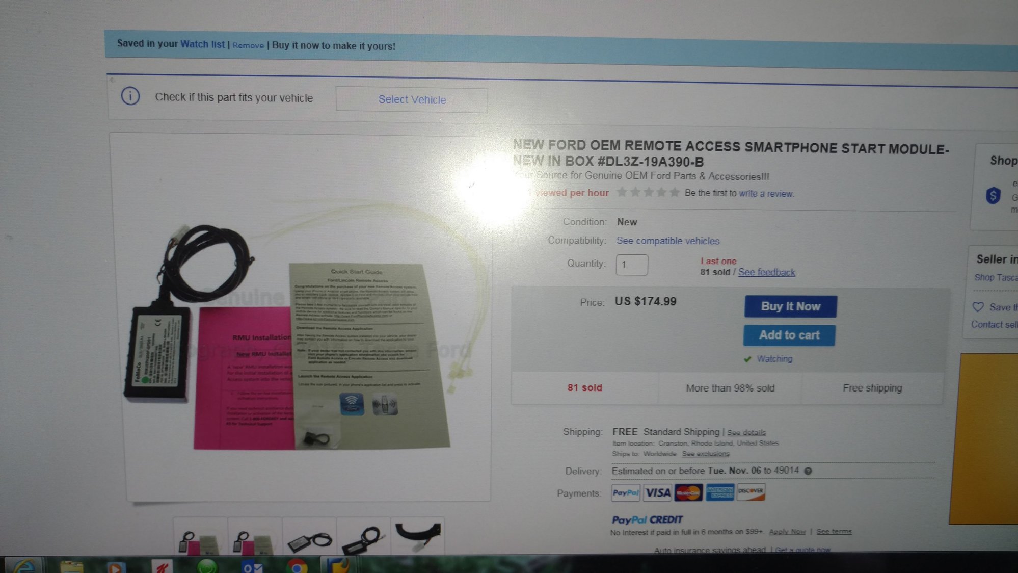

remote access starter parts
Are these two correct for my 18 6.2l? If so ill order them now

Weird. The link I posted that was working yesterday is now a Not Found page. Did the ruling council banish it?
I can't remember exactly but those part numbers sure look familiar. Pretty reasonably priced too, as many of them got jacked up as they became scarcer.

ya I looked up your post and "just stroking" posted these part numbers.....
The kit you saw on Ford Accessories is it. You can buy it a lot cheaper on eBay by buying the two parts, security module DL3Z-19A361-A and the remote access module DL3Z-19A390-B.
The remote access plugs into the security module. The security module includes a "jumper" cable that plugs into the current OBDII port and then you mount a "new" OBDII port in its place. It is a clean and neat installation with these kits.
Actually it is all plug and play. The only involvement from the dealer is to have them "activate" the remote access module and provide you with a PIN. Takes about 30 minutes max but suspect they will want to charge you for one hour labor.
If you were to buy a used/previously installed remote access module and the seller provide you with a transfer PIN, then no dealer involvement is required.
I just sold two modules and sent a new PIN to the buyer and he had no trouble activating them.
