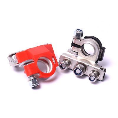

heavy duty battery connection
when I added a sub to the truck I switched out the factory battery connectors for something more substantial. That allows for adding additional cables.

I use this style on our service trucks. They are available online and local at the battery supplier. The ones I buy local I believe are made by Norco and say USA and run about 60.00 a pair but are solid and nice.

I've been looking for something just like that for the batteries on my trailer. If you get a chance, can you get a product number? I tried searching on Norco but all that comes up is Noco and they don't have it.
