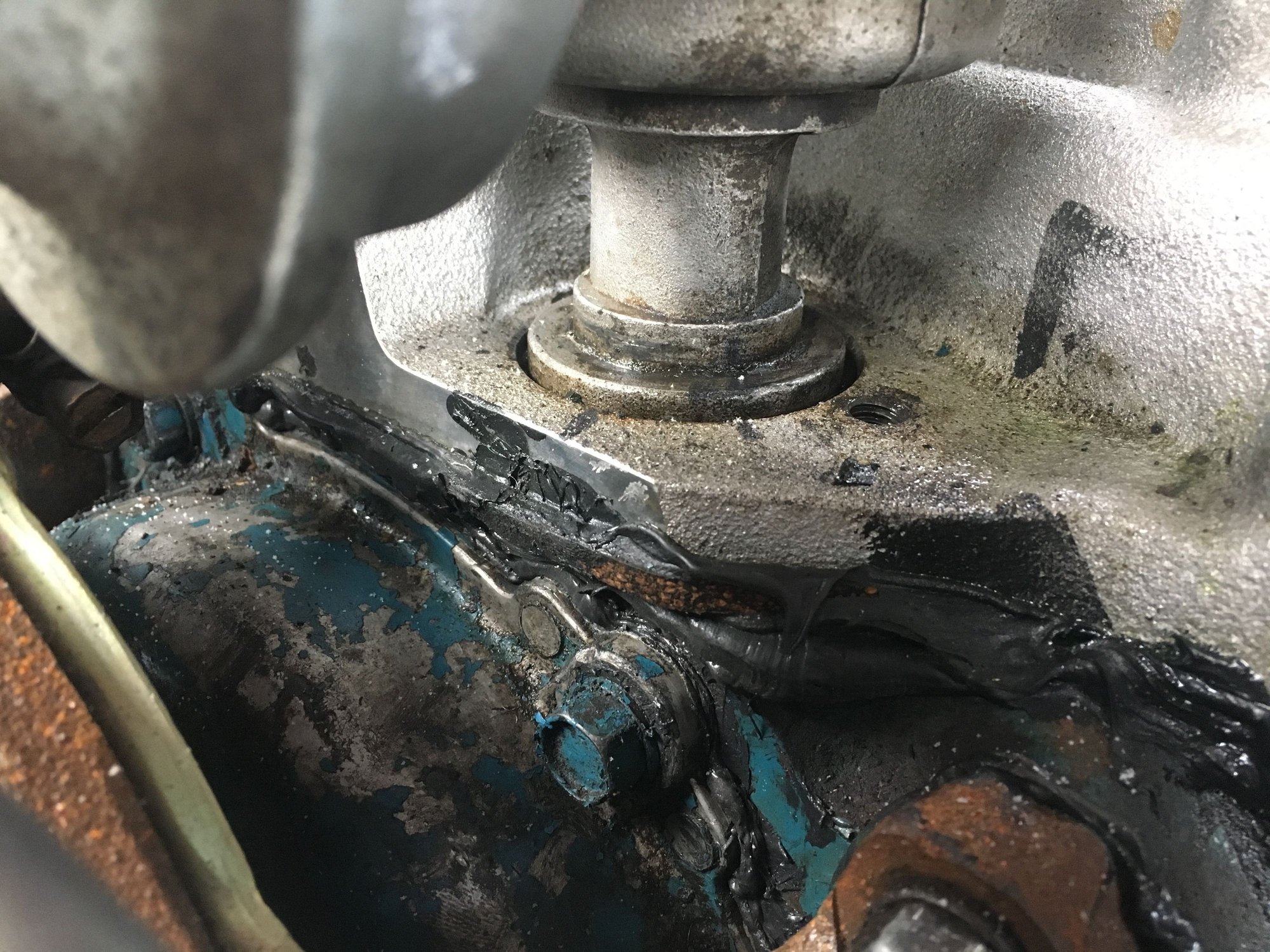

Hey everyone, just posting an update . Timing chain came and I got it all installed and everything back together about 4days ago . I wanted to give the silicone plenty of time to cure in this cold weather. Seems to of sealed up fine I ran it for about 5min . Still runs pretty rough . I’m hoping it just needs timing adjusted , hoping to get to that later this afternoon, I started it last night ,but the oil pump drive shaft is leaning over so I cant install the distributor. I’ll probably get some thick grease and put a whole bunch down there and mabey I can kinda get it to stay centered then. The chain was very loose on the left side
( standing in front of the engine ) and tight on the other side. I don’t believe it jumped a tooth because the dots still lined up . I was aactually hoping it did then I would known I found my problem. The new chain fits perfect and is good and tight . Only difference is I left the oil slinger off. Manufacturer says it will interfere with the new chain.

You have me confused. You say you started it last night and in the same sentence you can't install the Dizzy. The Dizzy had to be in there in order to start the engine.
And I've never seen the oil pump driveshaft over to one side far enough to keep the Dizzy out. Please post a pic of the Dizzy's hole and that drive shaft.

Haha sorry . After everything was back together from installing the chain I started it up and it was running bad . Next I pulled the dizzy to move it over a tooth and now I’m having trouble getting it back in because of the oil drive shaft.

I got the dizzy back in so I can’t take a pic of the shaft . I will if I have to take it back out again
But that’s how far it sits in there . Does that seem about right ? I wasn’t paying attention to that when I removed it what does the shaft leaning over mean ?
